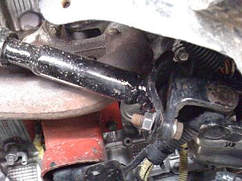

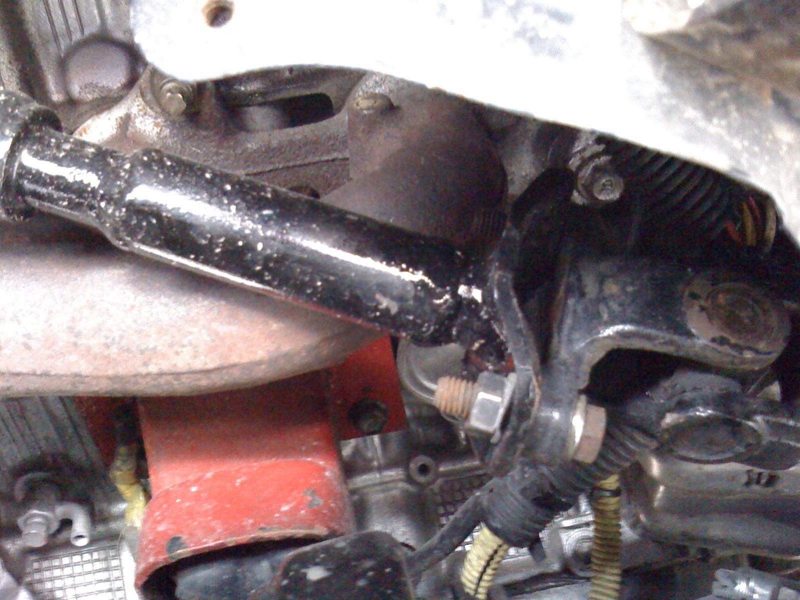

    maybe this has been done before
    i got fed up with the wooly steering so removed the rag joint.
    i had to extend the shaft with a 2" body lift to correct the length. with the rag joint removed turn the shaft until the holes line up to the u-joint and bolt it up solid.
    i have no steering damper fitted and 33" tyres and it feels much more positive on the road with no free play, wobbles or vibration up to 80mph.
    it might not work so well if you do a lot of offroad driving as the bumps and shocks will be transmitted straight back to the wheel with the rag joint missing.

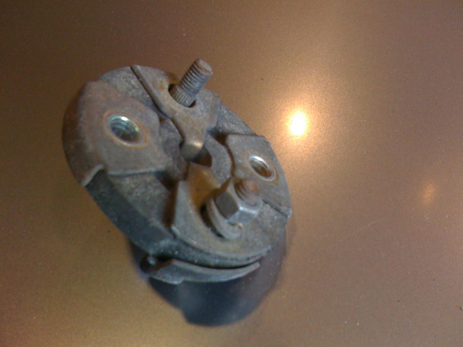

      excuse my ignorance but.... wtf is a rag joint
        The circle of rubber with fabric in it on the steering column joint - the one that shouldn't be bent when you lift the truck...
        www.johnthebuilder.info
          this is the rubbery bit that gets removed - its the reason for the vague steering in a surf. its basically a shock damper but you wont notice the difference on the road
          try moving the wheel a little left and right and watch how much it moves before the tyre does anything - repeat it after the rag joint is removed and the tyre does what the steering wheel does

            Sounds like a great modification. I'd like to do something similar but just need to clarify the changed out parts...
            The pics you posted - do they show the section you made ie the shiny black tube with the curved section of metal linked to the universal joint?
            Probably just being daft but just need a little bit more detail please.... although might help if went out to the truck and had a look at where the little doughnut type disc thing lives!

              there are no parts - the shiny black bit is the original steering shaft.

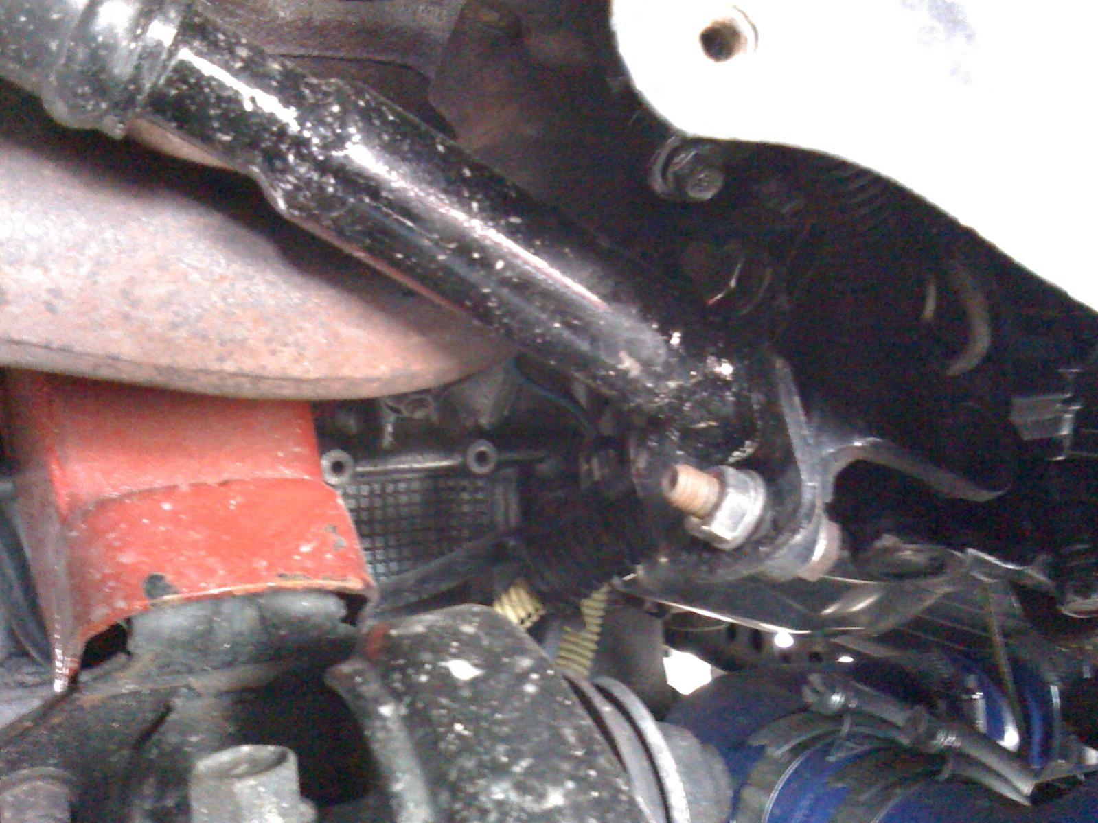

                What did you extend and how then? This sounds like a great mod. My steering is certainly a touch on the unresponsive side...
                  i had to extend the shaft about 20mm. having a body lift and removing the rag joint left the shaft a bit short.
                  easiest way to do it is remove the shaft from the car then cut the shaft around 1" above the bottom fixing plate. you now have 1 piece with a spline and 1 with the 2 bolt flange.
                  stick the splined part back into the fitting and attach the other part to the uj minus the rag joint - you will now have a gap between the 2 pieces. that is the amount to extend the shaft.
                  use a piece of pipe with a hole the right size for the shaft to sleeve it and weld it up.
                  any local welder will do it - its a 20min job.

                      its a good one for lexurf's vince - leaves loads of clearance on the exhaust manifold - and theres no rubber bit to get cooked anymore, that worried me a bit - the rubber used to get so hot it burnt my fingers
                        Does anyone know the PCD of the bolts? I fancy this mod too, but would rather replace the rag joint with a plate, or add a plate(s) to the joint.
                          No idea of the PCD, I had the joint on the bench and used it as a template to make the plate.
                          I'll be making another one for Lexurf VIII soon, want me to make you one and post it?
                          As you can see in the link below, I left the rubber part in and fitted the plate underneath with longer bolts and threadlock holding it all together. Doing it this way allows more of the splines to be gripped on the shaft after the bodylift, so it's effectively a solid spacer.
