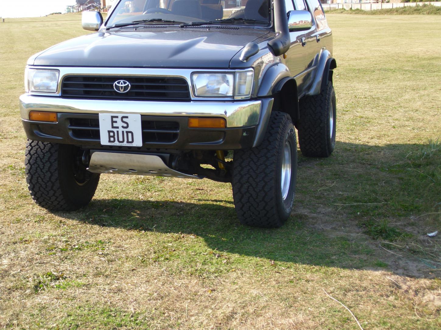

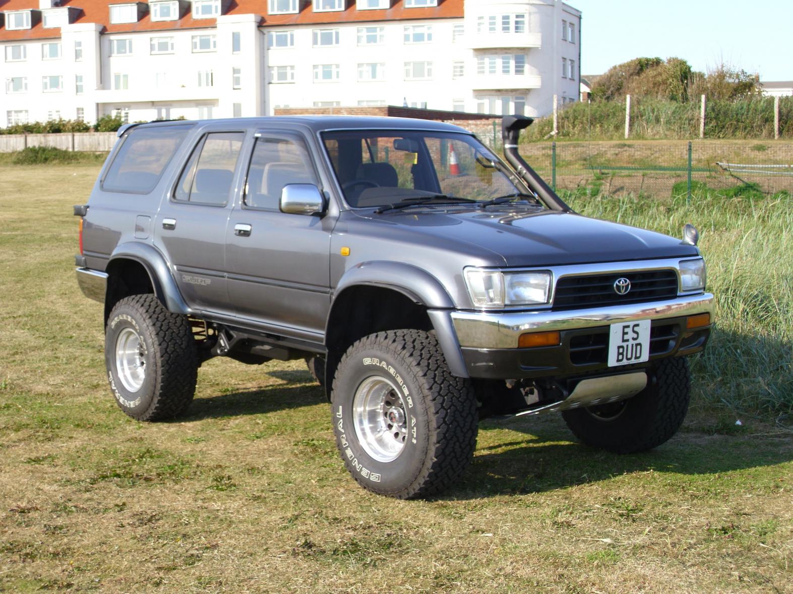

        I fitted these http://www.ebay.co.uk/itm/4x4-WHEEL-...item3f0d6579df
        on my 2nd jen to cover over size tyres. Easy enough to fit, not sure what they would look like on 3rd gen.
        couple of pics.
