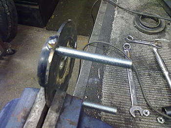

Completed my front end lift saturday, tested on a very severe greenlane plus "normal" roads, all working 100% very pleased. attempting to post pics with some explanation now....

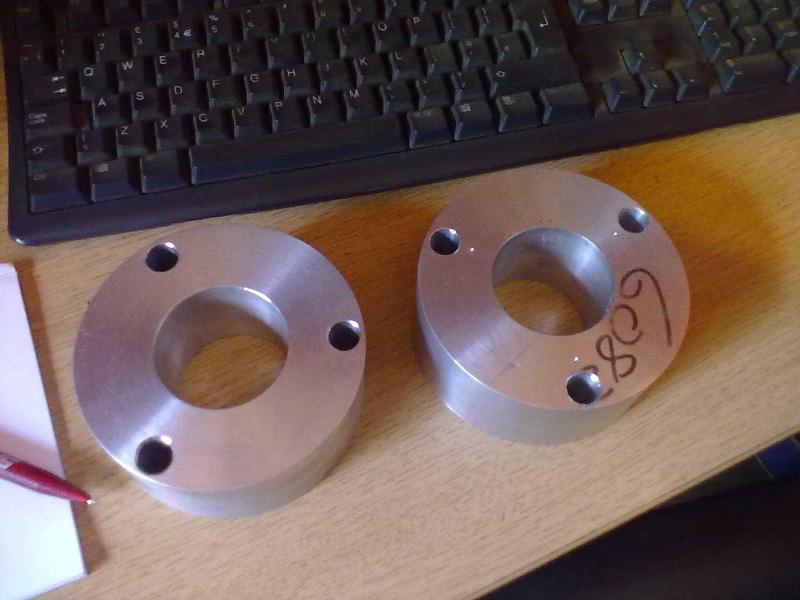

1st pic is of the alley spacers..

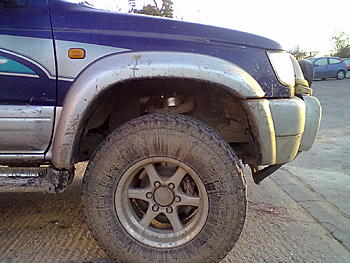

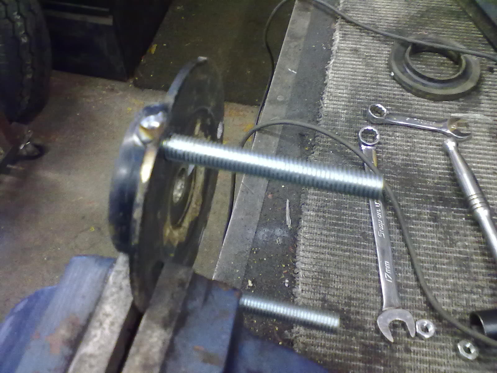

2nd pic is of the converted top mount, high tensile bolts

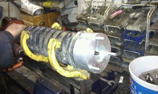

3rd pic is the assembled leg ready to fit back on vehicle

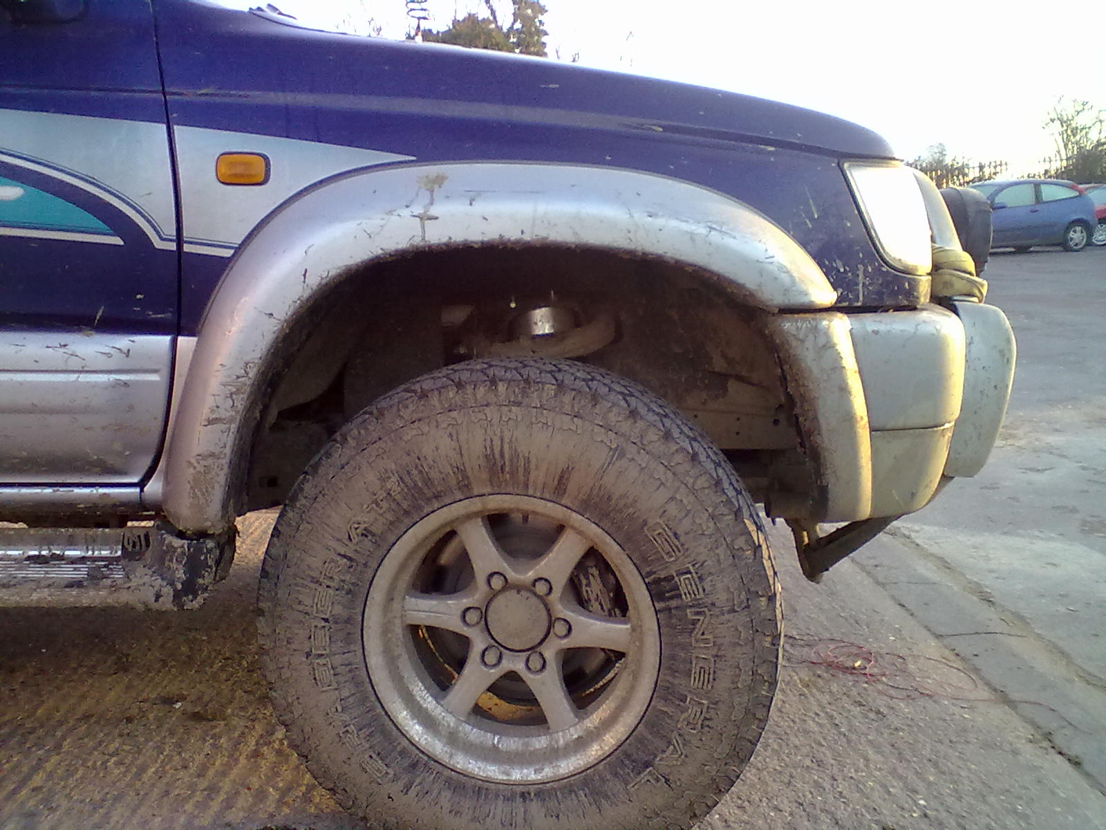

4th pic is the truck after settling
