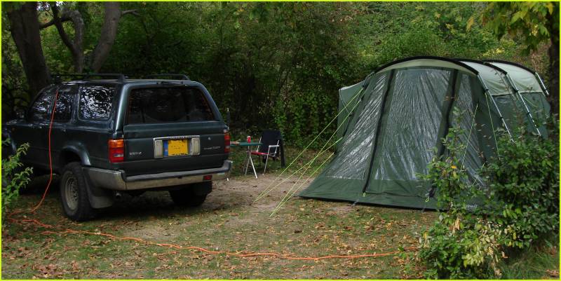

mines been like this since i first got it / did it instead of having a really naff looking piece of plastic crap hanging half smashed off the back of my car I did away with the drivers side reversing light wired the fog light wiring into it and put some red clearish tape over the lense works great and been fine for 7 years now just a suggestion
rear fog light simples
Mines the same, but someone has dipped the bulb in red paint... don't know the details, but it works a treat. looks stock aswell.Originally posted by oops motorsport View Postmines been like this since i first got it / did it instead of having a really naff looking piece of plastic crap hanging half smashed off the back of my car I did away with the drivers side reversing light wired the fog light wiring into it and put some red clearish tape over the lense works great and been fine for 7 years now just a suggestion
