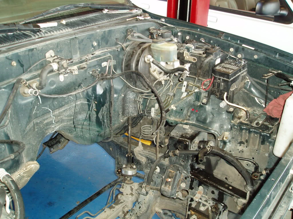

Roger Brown steering extension
as far as i know,a small 2" billet ally spacer wont foul anywhere on a 2" bodylift.,just make the diammeter of the spacer as small as you can get away with,or the alternative is a lengthened splined adaptor.but i think you will have to get one in from australia.because i dont know if rough trax stock them and i know la supertrux dont have any.Originally posted by Bald Eagle View PostHi guys, I'm doing a 2" body lift on my 3rd gen 3.0ltr turbo diesel and have read on here that the steering spacer will cause problems because there isn't enough room, if I get the one to suit a 2" lift. Will I get away with a smaller spacer and slackening the splind joints? I want to avoid cutting and welding the steering column.www.overfab.uk
