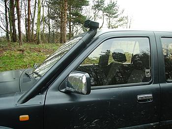

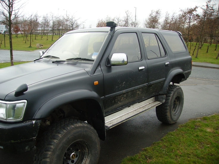

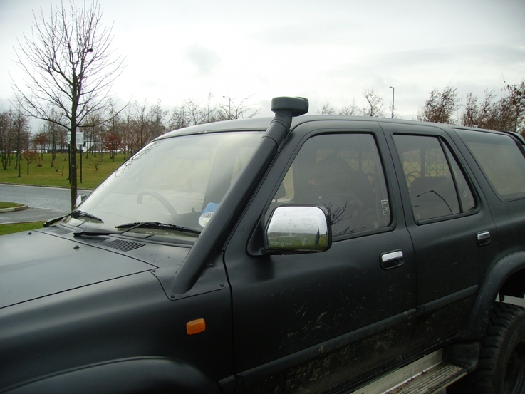

Pretty much the same as a few others that have been done, but I wasnt happy with the overall look, so tweaked it a bit...

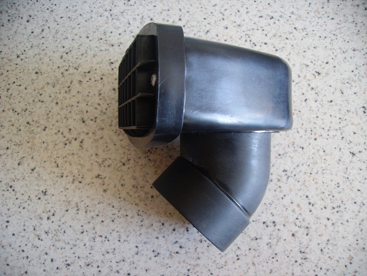

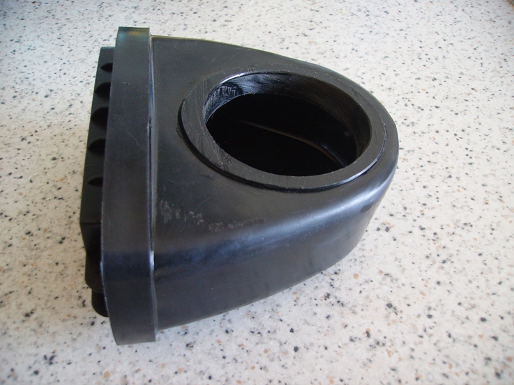

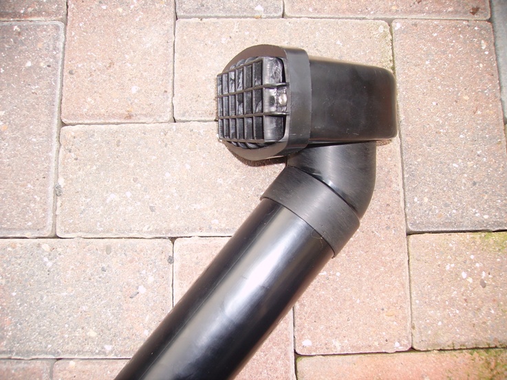

First, take one southdown defender head, and cut the swivel insert
off flush.

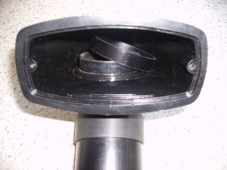

Cut the large lip off a 45 degree bend, insert smallest end into head.
Cut a 12mm sleeve out of 68mm drainpipe, place over bend showing through head, hold in place with screws.

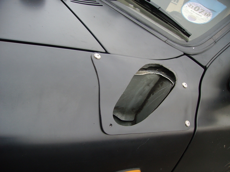

In voice of meerkat... Cut piece of drainpipe, cut along its length, and open up with heatgun. Use heatgun to mould to shape of wing, bolt on, cut hole for upright pipe. Simples. (
to be honest). Glue into place, all done.

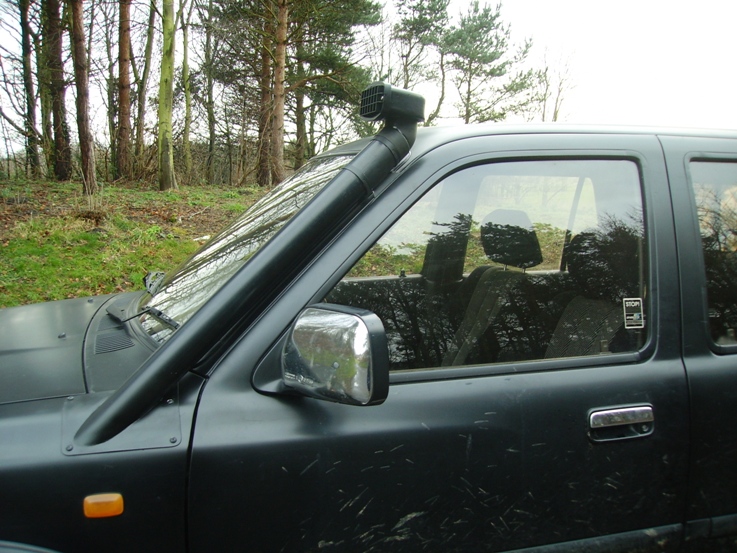

Head is now at the right angle, but still spins, bottom dont look like I made a hole and shoved a pipe in. Happy.
