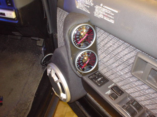

 Well a 52mm hole to fit it in depth verys quite a bit, normally around 60-80mm but some i got have a very deep back on em, also it depends wether the gauge has just wireing or tubeing from the sender, tubeing will need a bit more depth to avoid kinking the tube, the gauges i fitted in the door were slightly larger in dia but very shallow in depth, see if i can find some pics of mine, depth verys quite a bit, normally around 60-80mm but some i got have a very deep back on em, also it depends wether the gauge has just wireing or tubeing from the sender, tubeing will need a bit more depth to avoid kinking the tube, the gauges i fitted in the door were slightly larger in dia but very shallow in depth, see if i can find some pics of mine,
 one on the left is 52mm but deep, (others there are shallower) pic on the right, gauges are 60mm dia but only just over 20mm deepLast edited by POPEYE; 9 November 2009, 14:46.Too young to die and too old to give a toss
