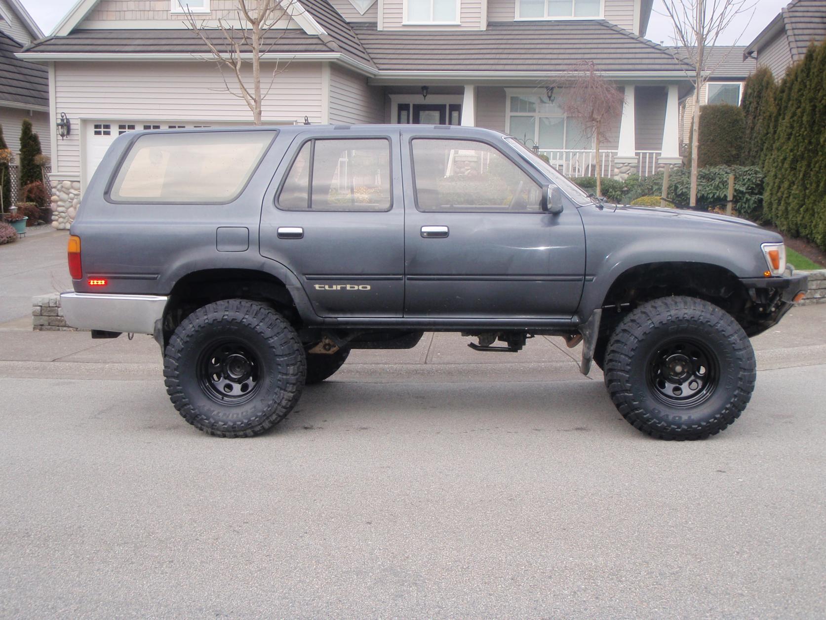

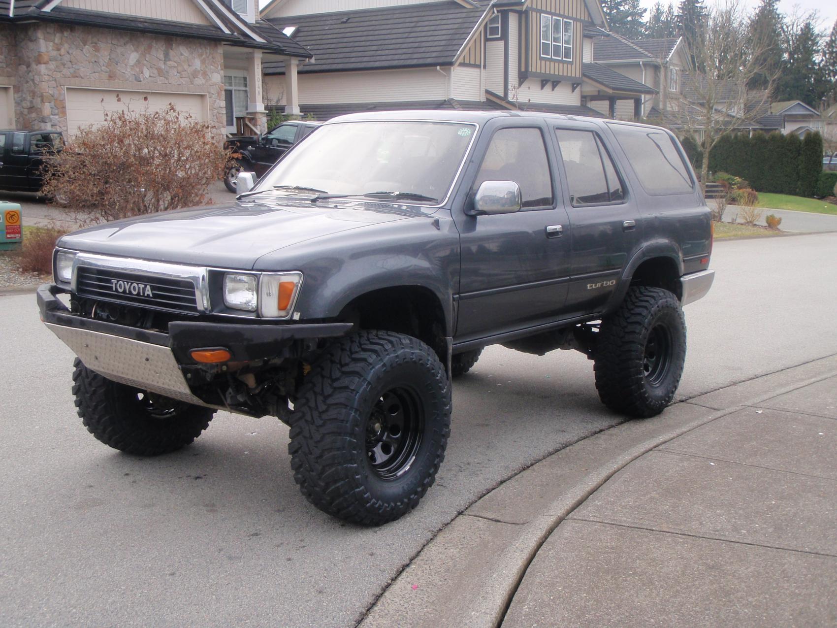

                                With my truck I recently put in an old man emu/sdori suspension lift and have been incredibly happy with the ride quality and performance. For the front I used OME torsion bars, steering stabilizer, shocks and 1.5" Ball joint spacers. For the rear I used 2" coil spacers with OME medium duty springs and a 2" panhard bar drop bracket.
