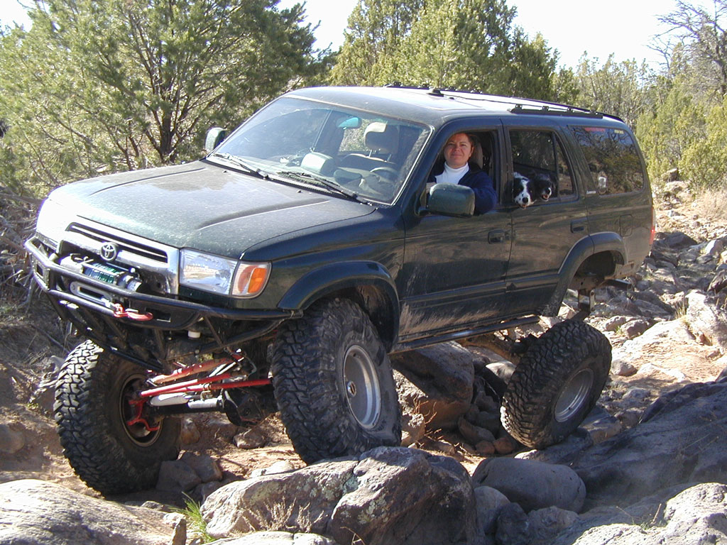

hi everyone, my mate has a toyota pickup, he has a live front axle where a son my surf i dont, can i fit a live axle to mine and what are the benefits/dissadvantages and mostly is it possible, basically i want a smuch lift and traction as i can as im really gettin into offroading now and i wnat all the help i can!! many thanks

 I'm pretty sure TonyN has done it as well. Also it's a really common swap in the US and lots of companies over the other side of the pond do kits with the weld on spring mount, etc. Have a look on www.Yotatech.com for some ideas.Roger
 3rd gens have a center diff which means that it can be run in fwd on roads therefore live SAS it as the pic above a totally different concept as it is done for articulation not for grip ......if grip is wanted lockers are the way forward' You've arrived on a rather special night. It's one of the master's affairs.'
 Bear in mind.. With more articulation you're more likely to keep your wheels on the ground an removing the chance of the diff slipping and losing traction..Originally posted by BioHazard View Post3rd gens have a center diff which means that it can be run in fwd on roads therefore live SAS it as the pic above a totally different concept as it is done for articulation not for grip ......if grip is wanted lockers are the way forward
