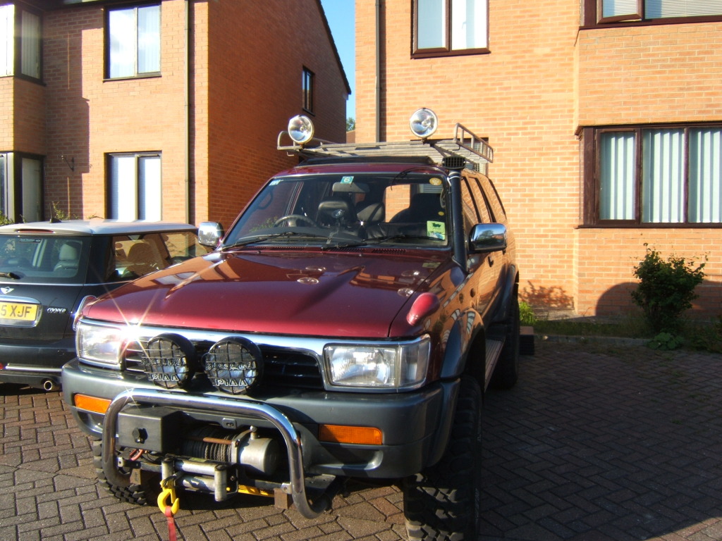

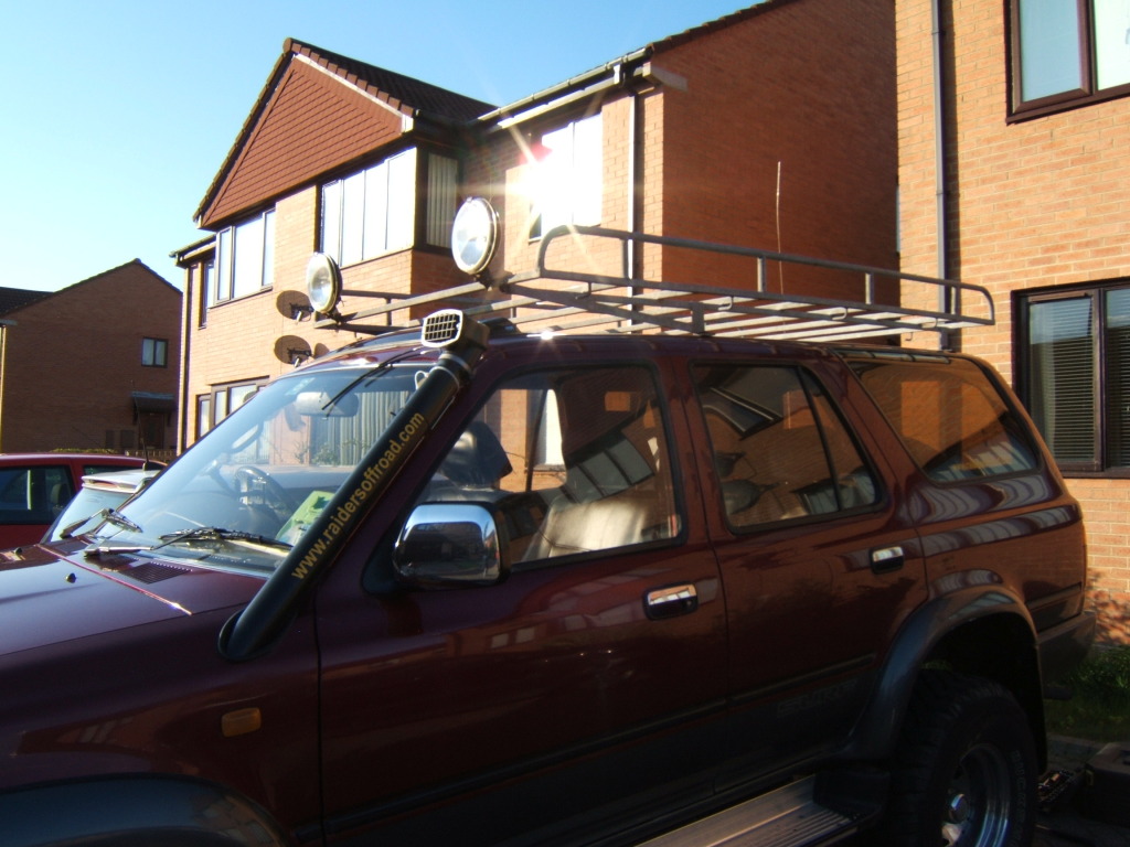

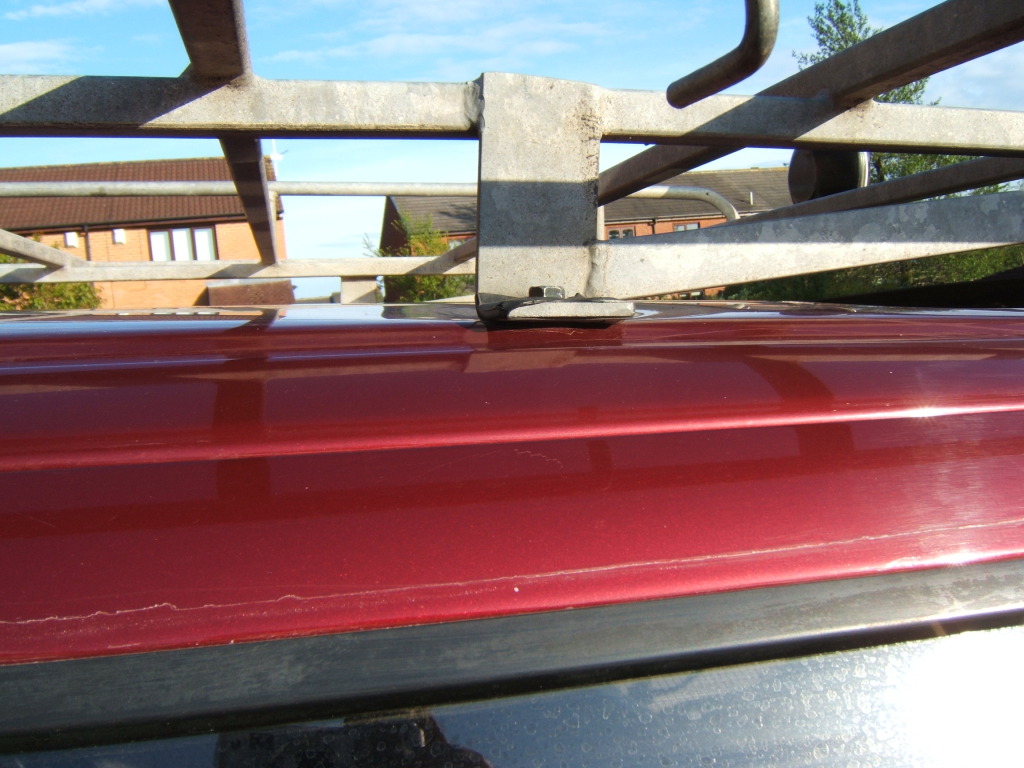

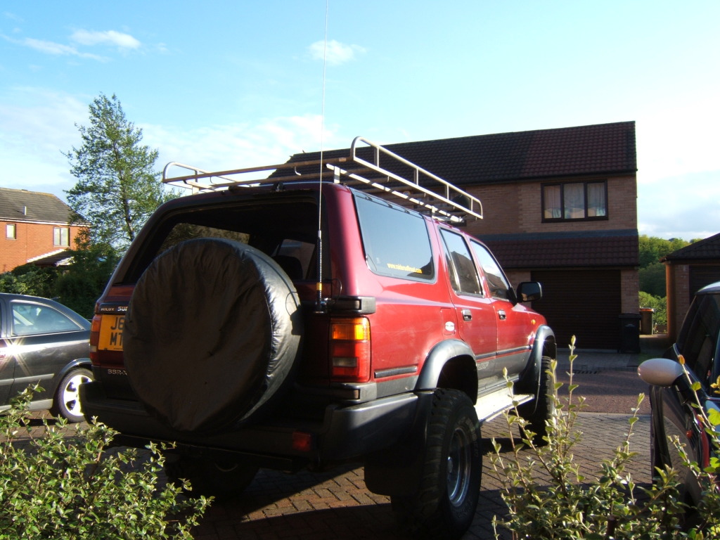

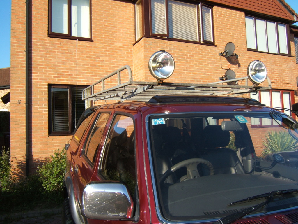

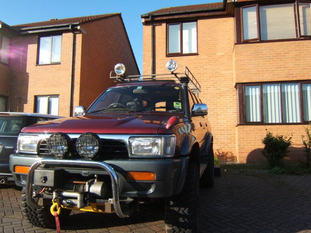

Hi people just wanted to show you the roof rack iv just put on,Its off a Renault Kangoo and a perfect fit to the under side of roof,iv just bloted it srtight to the roof ,but buy pure luck and chance they are perfect to fit on, A very strong cross member at the back of the truck ,and it just fits on the outsides of sun roof but once again there was a very strong place to bolt to,just used a few rubber gaskets and bobs ya dad,me and my girl friend have both been up on it with very little movement in the roof.

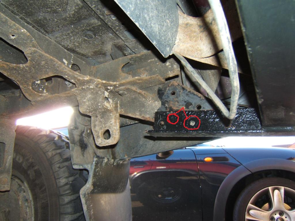

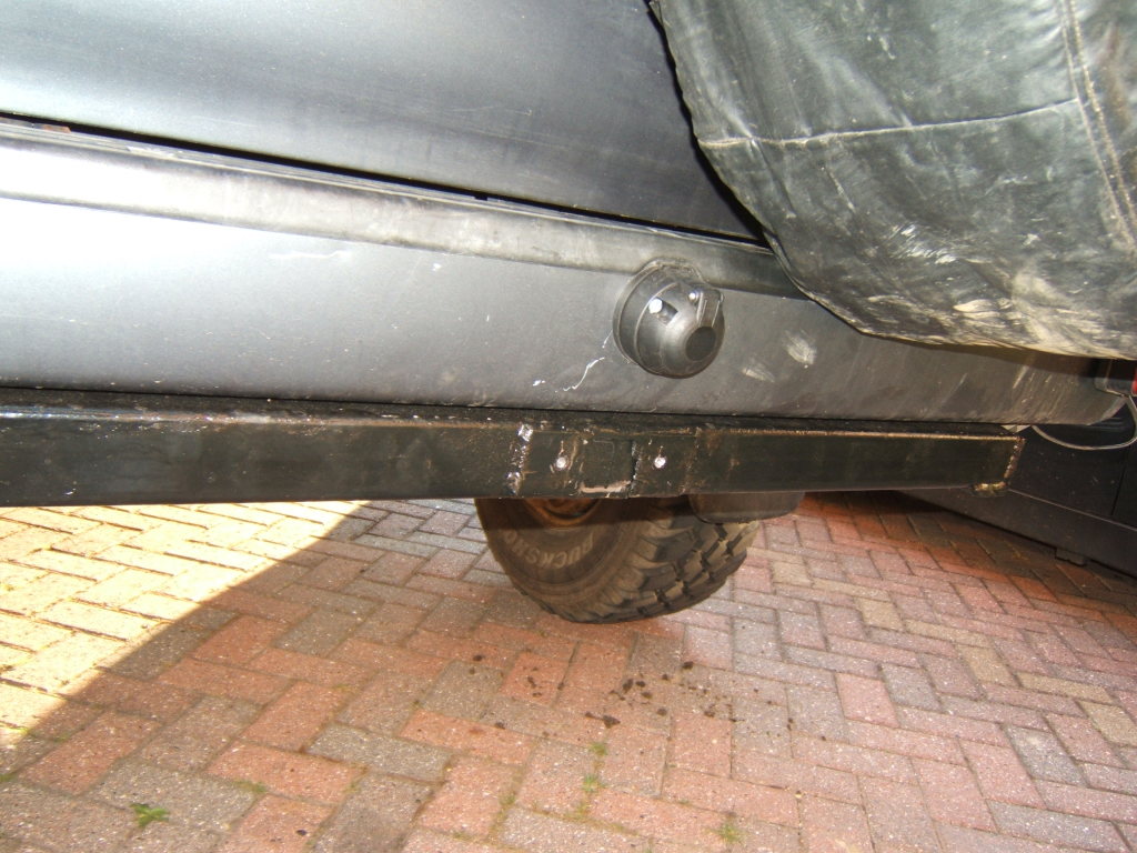

Also moved my tow bar and up, Anyone who has one of these style bar knows they just get in way when off roading so im in process of cutting the ball mount off and tucking it up close to the bumper,drill new holes, and mount a drop plate which i will remove easly when off roading,last moved the electric point to that hole in middle of bumper much cleaner,hope you like.
