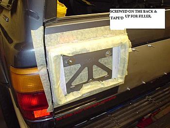

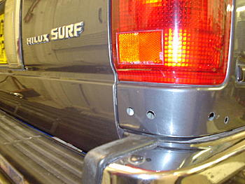

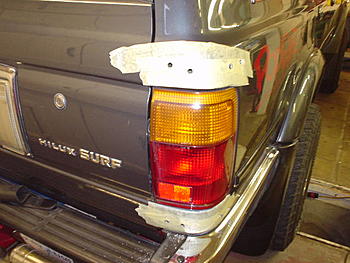

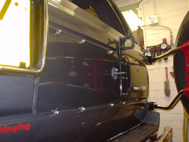

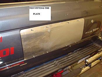

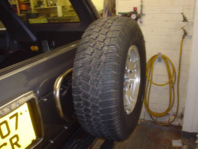

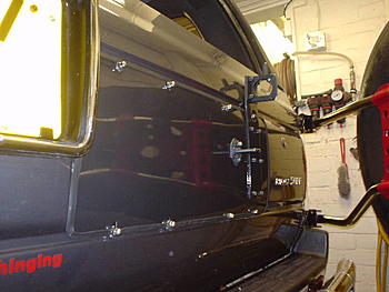

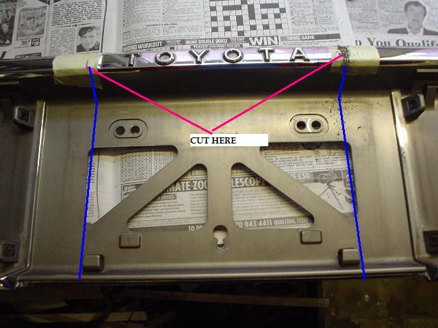

Thought i'd add this in case anyone wants to do a similar fit, took me a while to obtain a carrier as some will probably remember, anyway got one but not the latch plate so i'm going to have to make something, as i did'nt want to change the tail gate i decieded to "alter " some bits to suit, starting with the number plate surround--

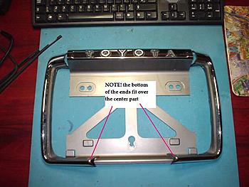

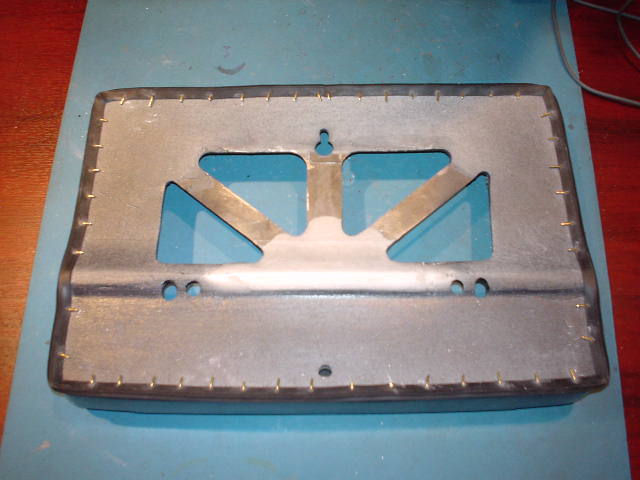

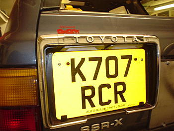

i quite liked the original surround and decieded to try and alter it (shorten it)

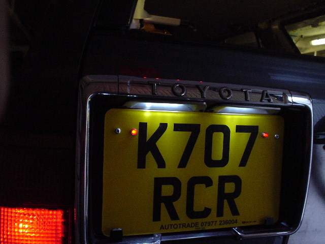

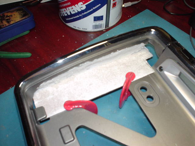

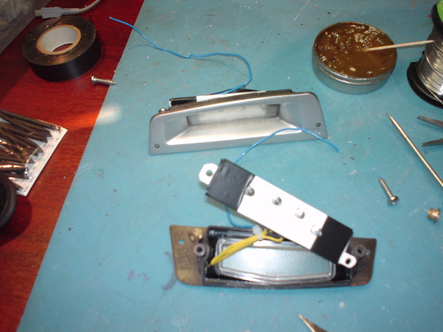

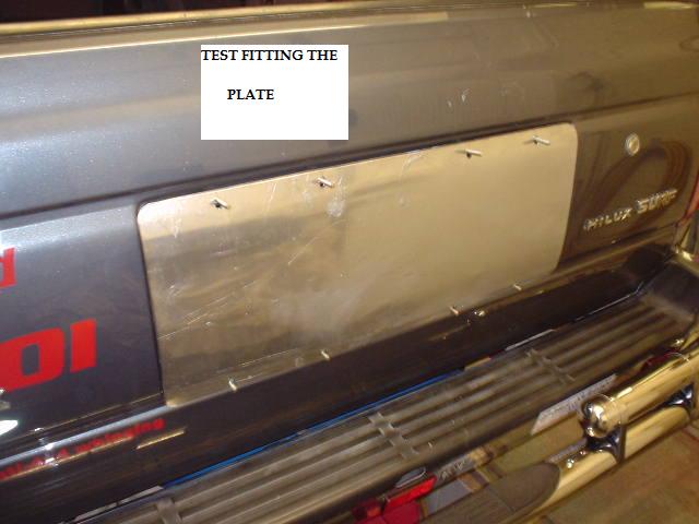

to fit on the n/s of the gate, the pic's show basicly what i did better than i can explain, luckily it's made out of ABS chromed plastic and is pretty easy to cut, and waste pipe glue was used to stick it together, along with some angle upvc bits and filler, i screwed it to the gate and filled it insutu so i got the correct contours, then sanded primed and sprayed with truck colour and finished with laquer, i used some ultra bright white leds for the plate lighting as the old holders were to big to fit in the top, last one is all bolted up and lit
(with some red leds for a bit of b0llocks)

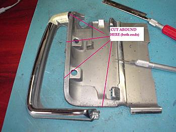

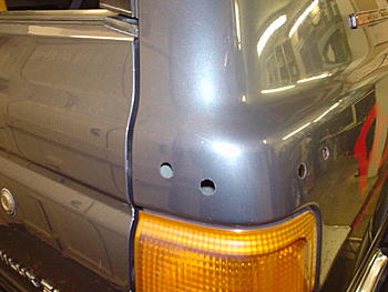

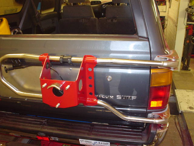

						 it's covered with red spray dust from the carrier painting tho, looks like the "ripley's" been at it
