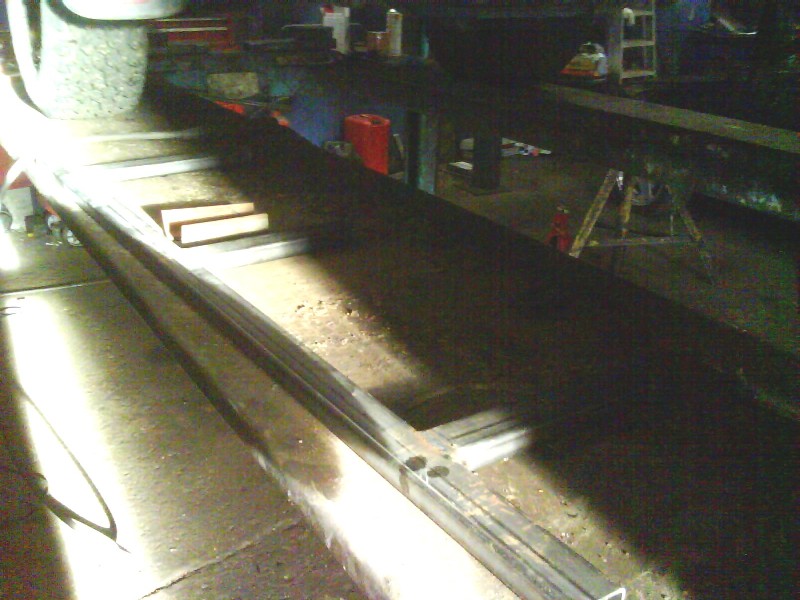

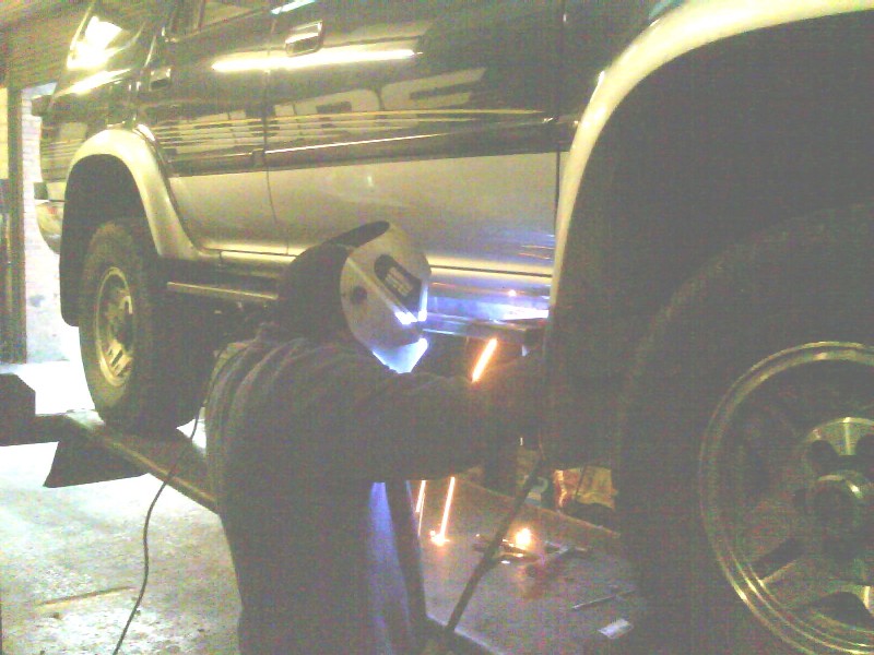

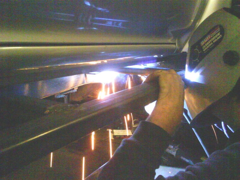

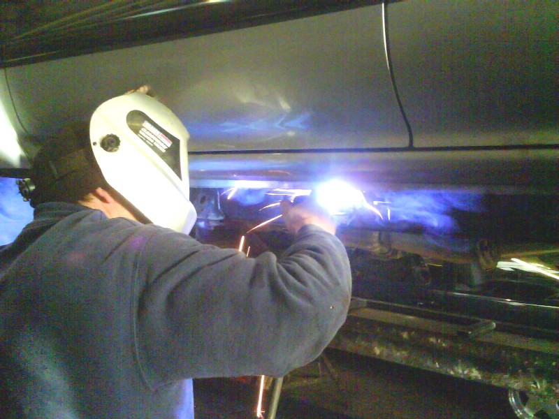

        Thanks for all the advice guys. I used the drawing as a start. Rocksliders now on. Have taken some pics so will post once complete. Complete means red-oxide primer, 2x coats hammerite and fitting the tread. I used steel box 50x30x3 I did all the measuring, cutting & grinding. I then spot-welded the struts and took them to a friend who did the serious welding!
        Feels great- another cheap mod done, cant wait till tomorrow to check them out in daylight!

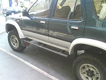

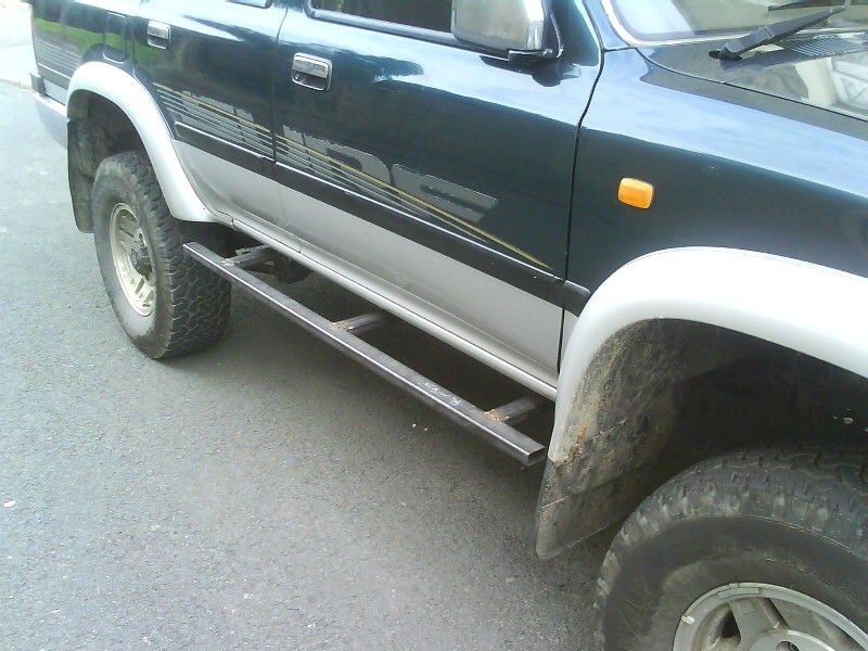

            Red-oxide primer on went on today. Her are some pics. I wanted simple but strong, lightweight sill protection doubling as a step. I dont think I will be using them as rocksliders or jack-points but I certainly believe they will stand up to a fair bit of off-road abuse. Also handy for your big mates to counter-balance you on those unstable axle-twisters!
            May add chequer-plate later. I need to seal the ends as well.
            Well, I`m certainly grinning from ear to ear! Will add another pic when complete.

                Great looking sliders mate, You've got a 1.5" body lift aint ya?
                Any ideas on total costs on them?
                  Hi Rod, yeah, the bodylift gives the extra room. I dont know the total costs but the steel was £20 (and i`ve still got 6ft. left) and the cutting/measuring of the pieces took a few hours with a recip saw and grinder & then there`s about 2 hours on the lift for the main welding.

                          Thanks, Vince. Yes, the rails in the plan are 64". I made the rail 62". I think there will be space for 64" but it may be touching the front-mud-flap. The side-struts are the correct distance apart on the rail and leaves nice space around them on the chassis for attaching. I altered the length of the side-struts by measuring from chassis to the welded body-seam. Mine stick out abit but I`ve yet to widen my track!!
                          I`ve just been to check and their seems to be plenty of space for 64" rails.
                          Maybe there is a difference between the two 2nd models? My advice- check and double check any measurements physically on the vehicle (even if its from a plan drawing!).
