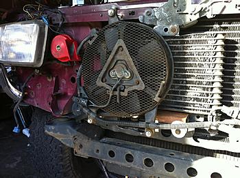

Bit of a thread revival but im interested in one of the trans cooler that boyo fitted but can't find the same one.
Have found fluidyne coolers but not that specific one.
Anybody point me in the right direction please.If its not broke don't fix it.
Thanks vince, I did look on eBay & on the fluidyne site "honest".Originally posted by BUSHWHACKER View Post
Just one more question, I'm assuming that the 3rd gen will be virtually the same with regards to the pipe work?If its not broke don't fix it.
You could use any similar sized cooler for the transmission, just search for an oil cooler with 10mm hose tails.
If you type transmission fluid cooler or ATF cooler, it'll yield far less results.
Coolers are basically just a length of tubing, formed into a square-ish design, with cooling fins attached.
Cheers for that, will have a look about.Originally posted by BUSHWHACKER View PostYou could use any similar sized cooler for the transmission, just search for an oil cooler with 10mm hose tails.
Coolers are basically just a length of tubing, formed into a square-ish design, with cooling fins attached.If its not broke don't fix it.

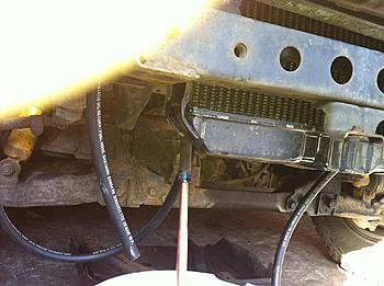

wish i had known that before i did thisOriginally posted by Hazzo View PostRover 75 oil cooler from the scrappy slot into the valance just nice with easy fix to the chassis via two B&Q L brackets, I couldn't be doing with stripping the front off a truck to fit a cooler. H
