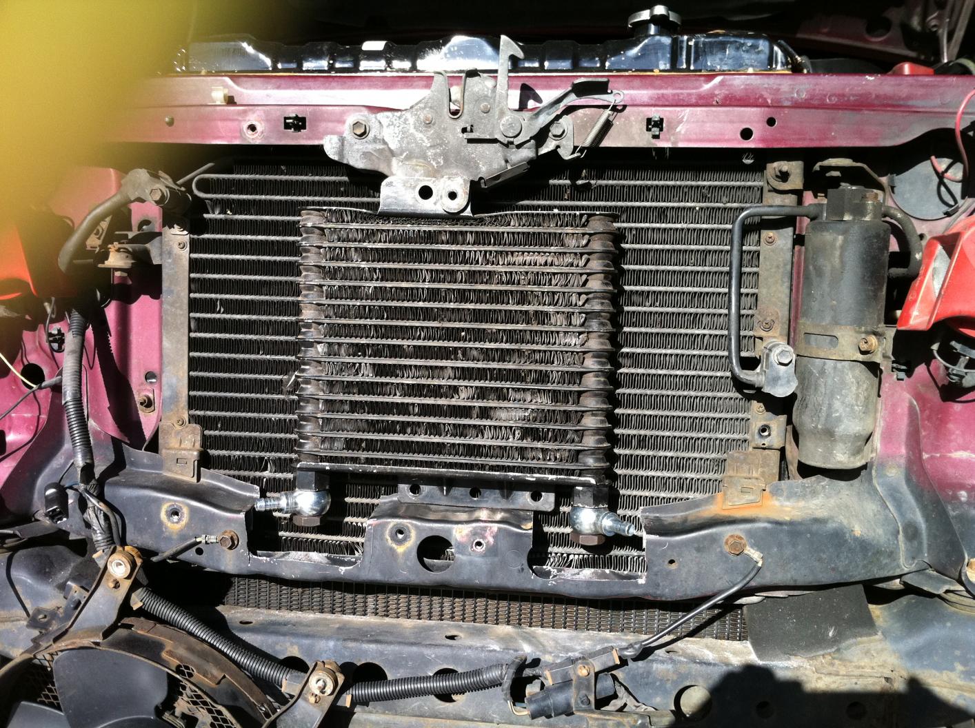

Going from memory when I did mine a few years ago, the hot inlet is the o/s of the radiator and the cool return is the n/s.
Fitting a transmission cooler
Originally posted by king kong View Postjust reading your post on the oil cooler mod and looking at doing one my self, can you just clear something up for me you say the pumped atf is the line on the right side of the rad, now is that the right hand side looking from the front of the truck.
Ask Apache! he did it not long sinse but i cant remember wot he said,Too young to die and too old to give a toss

Originally posted by BUSHWHACKER View Post.
Just one more question, I'm assuming that the 3rd gen will be virtually the same with regards to the pipe work?If its not broke don't fix it.
You could use any similar sized cooler for the transmission, just search for an oil cooler with 10mm hose tails.
If you type transmission fluid cooler or ATF cooler, it'll yield far less results.
Coolers are basically just a length of tubing, formed into a square-ish design, with cooling fins attached.
Originally posted by BUSHWHACKER View PostYou could use any similar sized cooler for the transmission, just search for an oil cooler with 10mm hose tails.
Coolers are basically just a length of tubing, formed into a square-ish design, with cooling fins attached.If its not broke don't fix it.

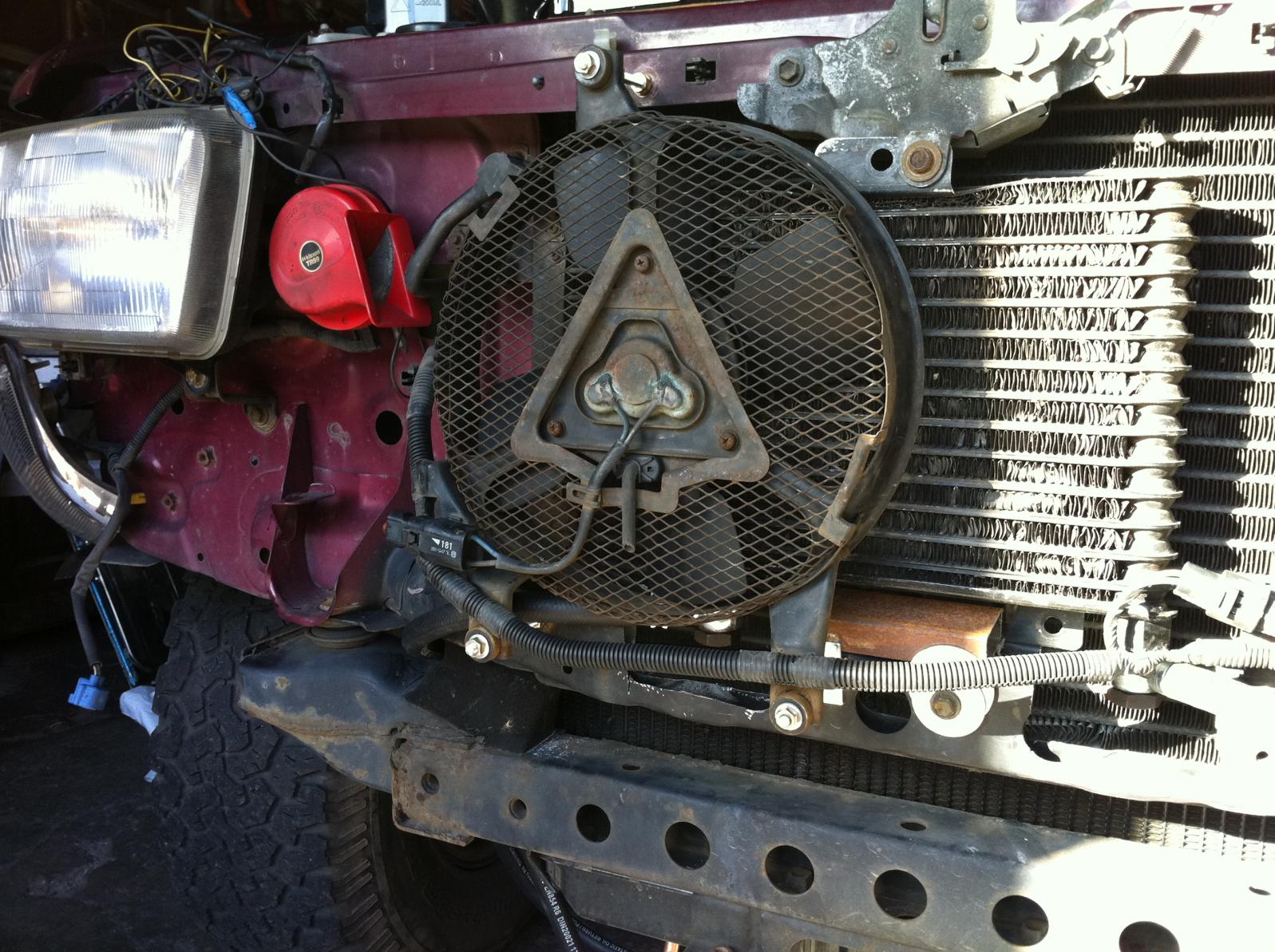

Originally posted by Hazzo View PostRover 75 oil cooler from the scrappy slot into the valance just nice with easy fix to the chassis via two B&Q L brackets, I couldn't be doing with stripping the front off a truck to fit a cooler. H
