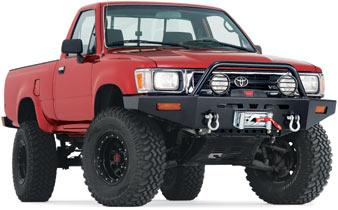

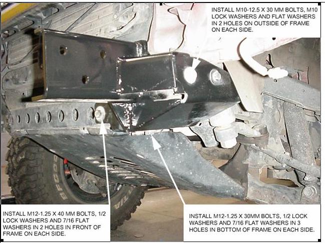

for those of you that have more experience in this field, can you cast you eyes over the following image.
It is of a pickup, and a 2wd one at that. What is interesting is the front end of the frame rails and their relationship to the headlights, wings and grill. It does look remarkably similar to the 2nd Gen surf.
The first picture was taken from the mounting instructions for the new Warn front bumper for the toyota pickups... Apparently it should fit a surf (or 4runner)... anyone care to comment?
