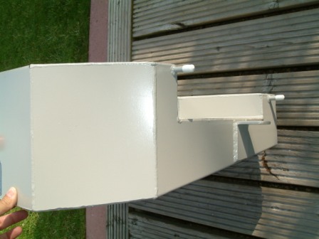

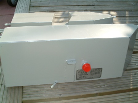

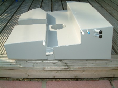

And here it is...
Yes Tony, about time. Apparently 4 weeks after ordering it, they hadn't even made it. Hopefully, it wasn't a rush job, but they ended up air-freighting it over. GKN are the UK dsitributors and they sat on it for almost two weeks.
Too excited about my new toy... actually read the receipt... actually £523.00 so feel even better about it. Something about the exchange rate fluctuations..
Its even got a 'Long Ranger' sticker in the fitting kit, how sweet!

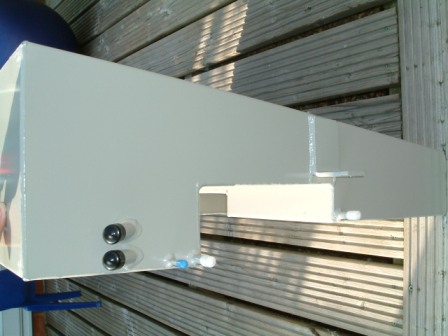

Is it steel or aluminium?

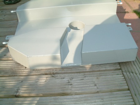

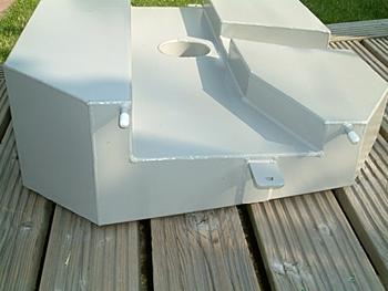

Is there any reason why you kept the hole in the middle for your spare as I guess you will not be putting the spare on there?
Also is the shape tapered so that you get more room at the rear?
The spare is supposed to fit below, and only 40mm lower than normal.
Angle of the dangle is to fit in with the departure angle.
The hole in the middle is a standard design for Long Ranger. They do a 130litre one as well, but that means moving the spare onto the rear... (and no hole in the middle)

Indeed the weight issue is an interesting one. Placing approx. 60 - 80Kg directly behind the rear axle would make things very interesting (100 - 130Kg even more so). I wanted to get an extended main tank (between the axles) as that would offer the best weight distribution, but unfortunately no one makes one, or a custom one would have been too expensive (all the big firms wanted to charge me for making their pattern!). Saddle tanks were another option, under the sills, but not enough room there to make it relatively safe. Behind the rear, above the spare was the only option left. Main reason for going with a branded product was that it is a major safety issue, and wanted something that had at least been tested. I do the same thing with brakes on my truck.
Permanently fitting locking jerry can holders to the rack would stop me getting into any multi storey car park anywhere near where I live. Although that may not be a bad thing... And is still under consideration. Done a fair bit of touring in Spain, and would like to do some more, still have a lot of family and friends there. And North Africa seems to have been calling for some time, serves me right reading Chris Scott's Sahara Overland...
Standard fill option for this particular tank (TA37S) is that it fills through the drain plug on the main tank, and its a gravity feed. Only problem with that is that it will allow fuel to move between the tanks in both directions. The 130Ltr tanks interface with the main guage and/or pump from the aux tank to the main tank. (nicer option, but a lot more weight)
