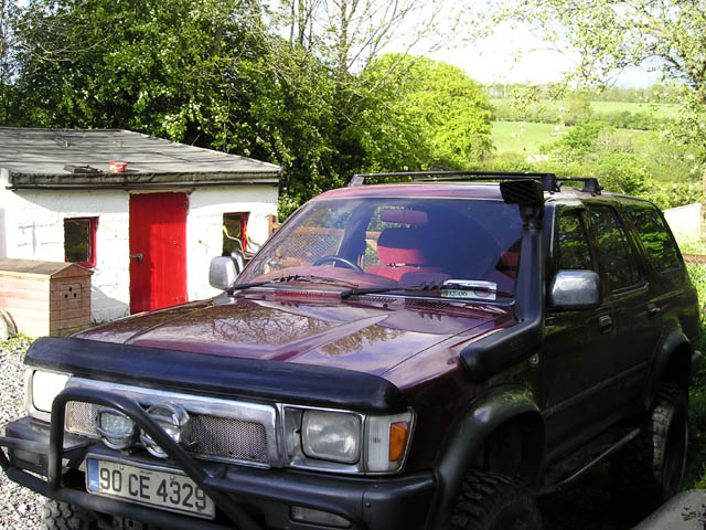

Managed to get my snorkel installed last weekend.  Big thanks to Roger for a loan of his hole saw.  What a pita it is to install, especially having to grind away a section of the inner fender to fit the pipe supports.  Managed to slice my fingers to bits forgetting that when you cut a hole in bodywork, its sharp.
 What a pita it is to install, especially having to grind away a section of the inner fender to fit the pipe supports.  Managed to slice my fingers to bits forgetting that when you cut a hole in bodywork, its sharp.   The little bit of tube that goes form the air box to the snorkel is the wrong shape and had to be cut.  Gonna replace it with a different one sometime, but it will do.  The little screws and plastic clips they supply for fixing to the a-pillar are useless too, so i bolted it through by cutting a hole in the inside of the a-pillar which was again quite awkward but at least i know it wont some off now.  Anyway, my pics are at home and i'm in work, so i'll post some later.
