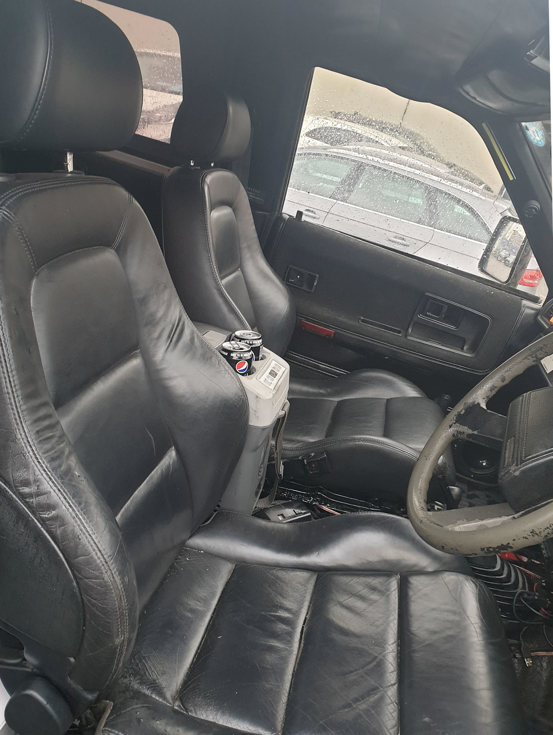

Here is my build log on how I managed to fit Audi TT mk1 seats in a 1st gen Toyota Hilux Surf (1st gen 4runner)
Audi TT seats in a 1st gen Toyota Hilux Surf (1st gen 4runner)

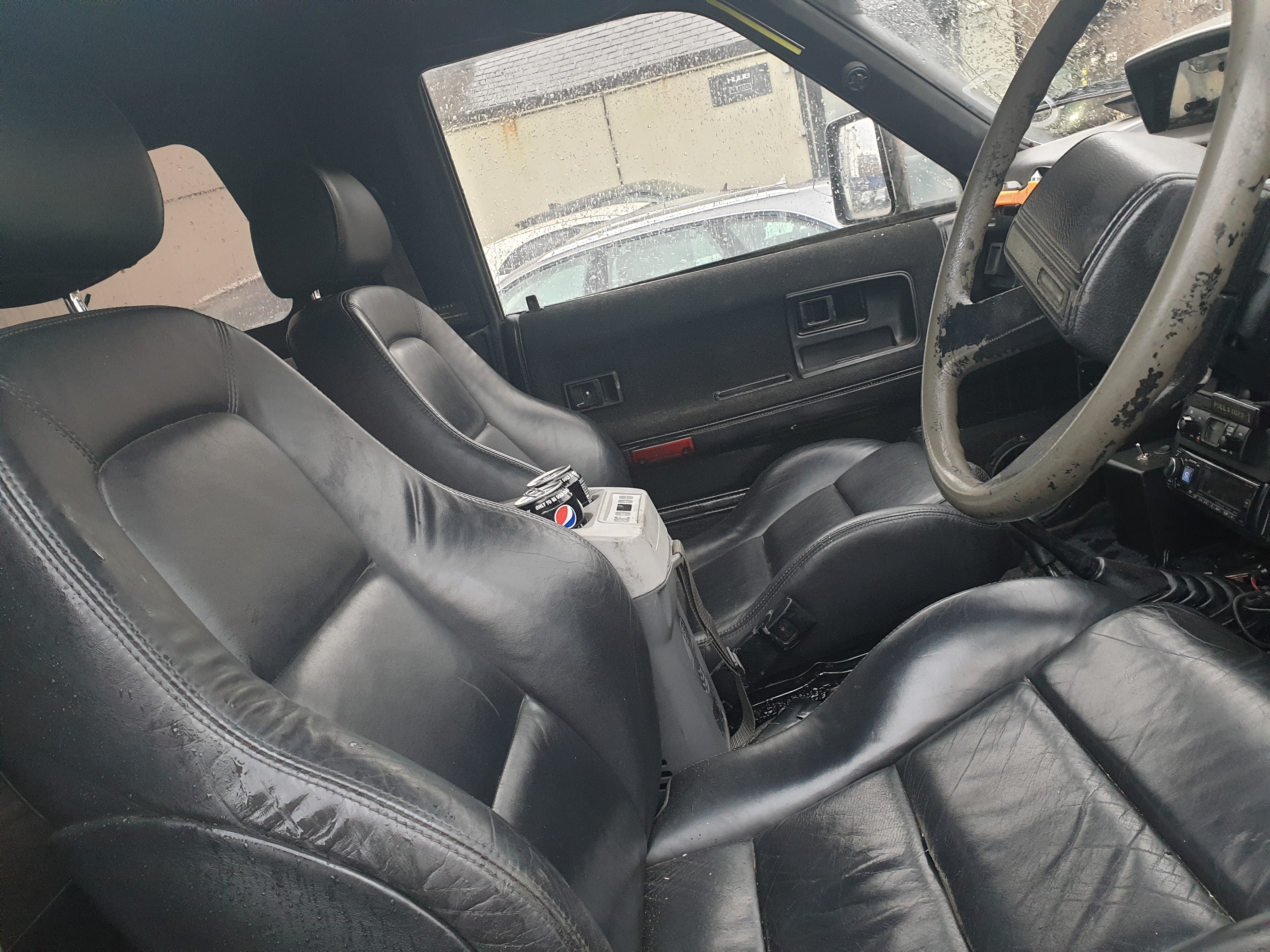

So in essence here is what I did:-
1) Bought some Audi TT mk1 heated seats
I chose these because I wanted black leather (easy to wipe clean), because I liked the look of them, and because they're from a 3 door car so have option to fold forwads

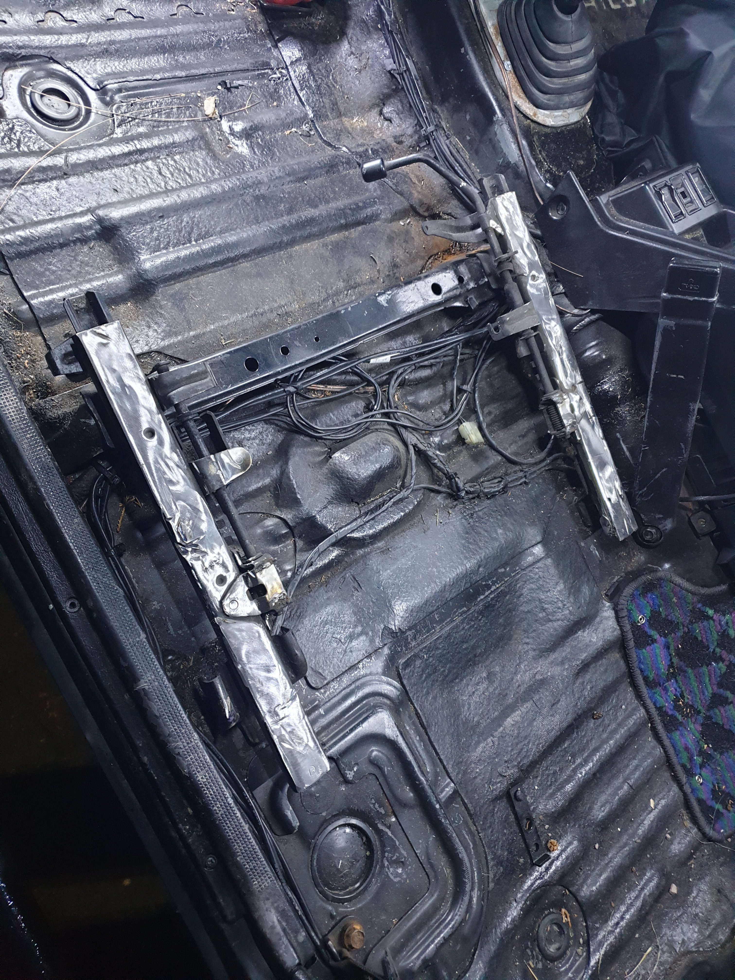

2) Took the original Toyota seats out
Easy enough. 4 bolts each seat.
3) Figure out how on earth to combine the two
The Audi seat bases are completely different and in no way going to fit in the Toyota without a bunch of work. So I basically spent ages staring at both the Audi and the Toyota seats trying to figure out how to create a hybrid of the two
Plus the Audi TT seats sit much higher, and I need them to sit at the same height the Toyota seats did.
4) Cut the seat bases off the Audi TT mk1 seats
5) Cut the seat bases off the 1st gen Toyota Hilux Surf (4runner) seats
6) Put the Toyota bases on the Audi seats
7) Fit!
In the following posts I'll include some pics of during the process, and include a bit more detail of what I did....

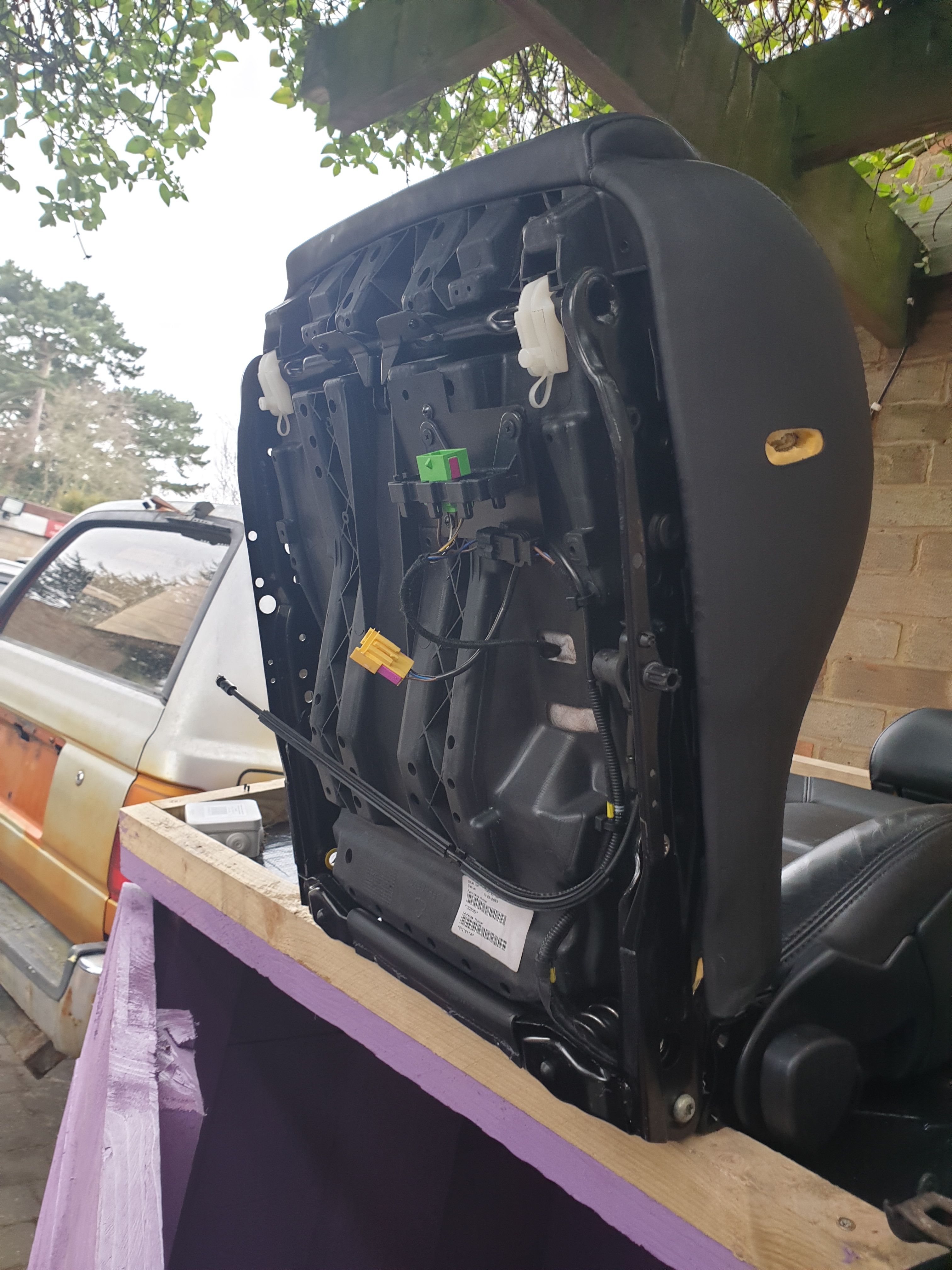

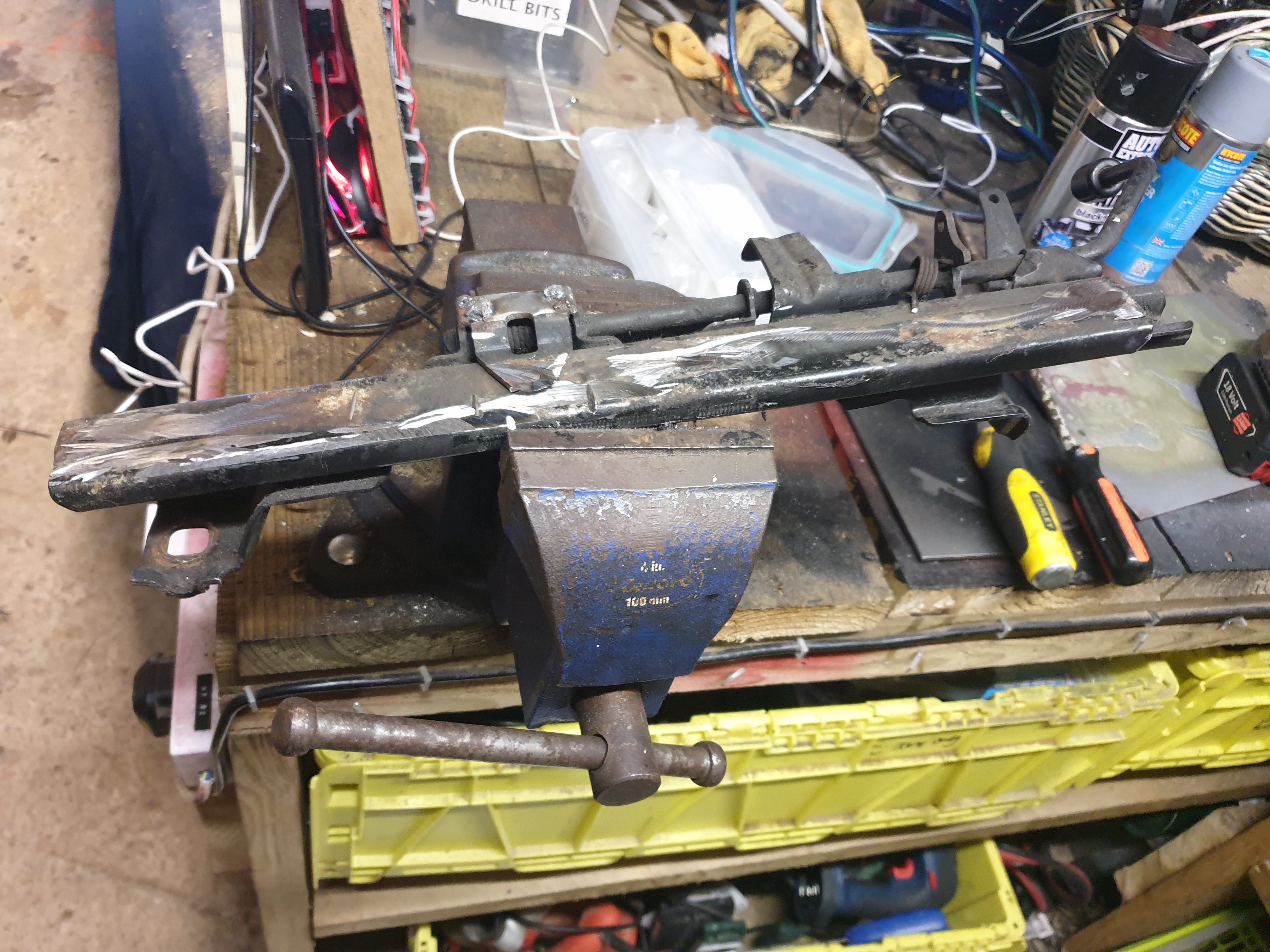

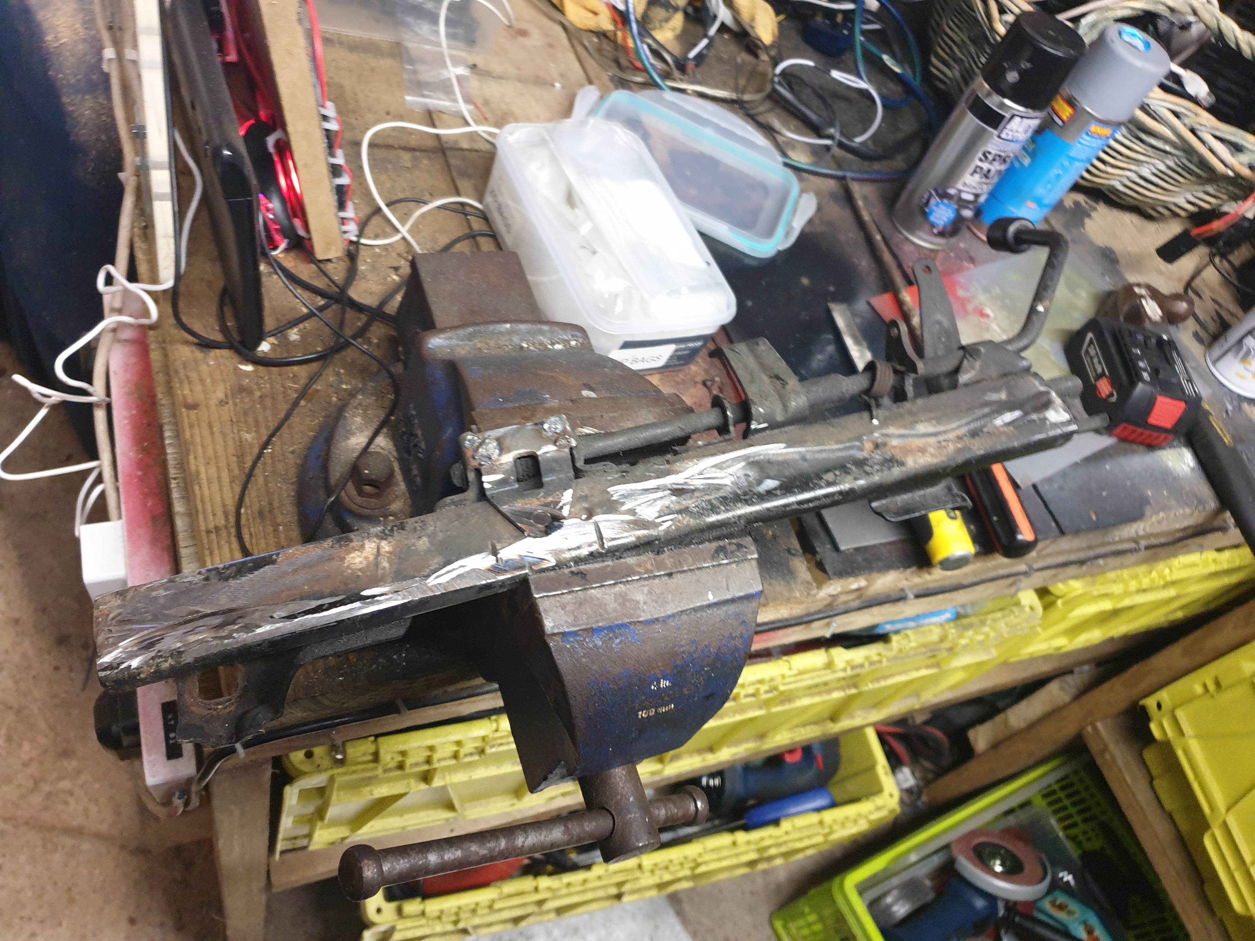

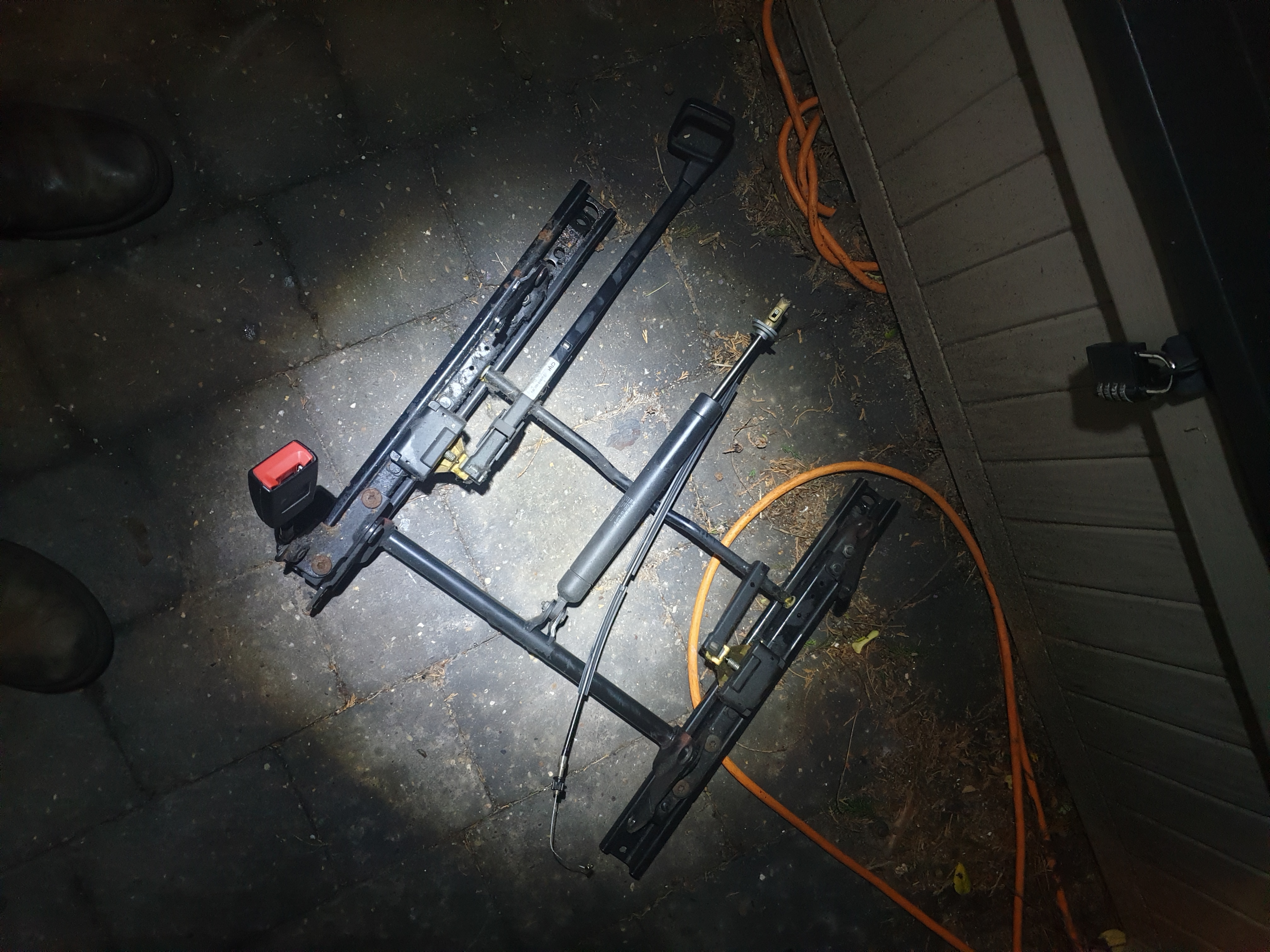

Removing the bases from the Audi TT seats.
There was a lot of crap I just didn't need which I removed.
You'll notice there are wires for the heated seats and airbag. Airbag I'll ignore, but eventually I'll connect the heated seats up.
Pictured is the seat base from the Audi seats removed, and the actual seat base itselfThanks
