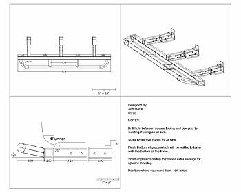

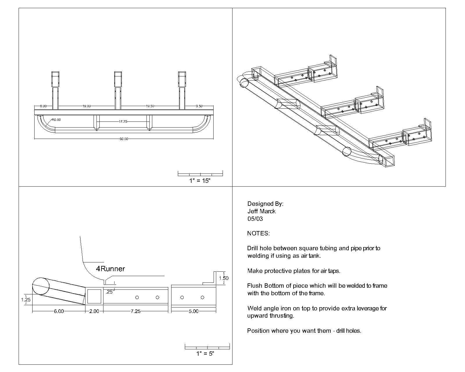

              Andy - they look perfect - any idea how much it would cost to get these made up? Bolt on... I'm thinking stainless..although that will probably treble the price...

                        Maybe we should see about getting a few sets made up - the missus has said that she needs some kind of support to get in to the beast so If I take the side steps off I will have to put something there. I have sent the plan that andy posted to a steel fab place to get a price for making them up - will let you know when they come back with a cost...Although I can't imagine they would be that hard to make - If only I had a pipe bender...
                        I think that plan is for a 3rd Gen so would have to check dims etc for a 2nd Gen but should give some idea...
                              I've got an Autocad drawing for the sliders I made for my 2nd gen. They're square tube so not exactly what you're looking for but they clamp onto the frame so no welding and that part should be useable. Let me know if you want a copy.
