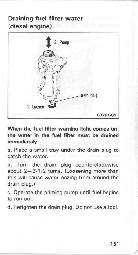

    OK, how do you do it?
    What about the thingy at bottom?
    Do you just unscrew it or does it need drained first?
    Go on please tell

    Unplug the wire, unscrew the whole thing from the metal mounting bracket, empty it out, then remove drainer at the bottem and put it in your new filter. Once you have a new filter in your hands, it odvious. Quite often, the filter is really tight, you'll need to remove the whole fitting from the car and get it in a vise.

              Heres a piccy
