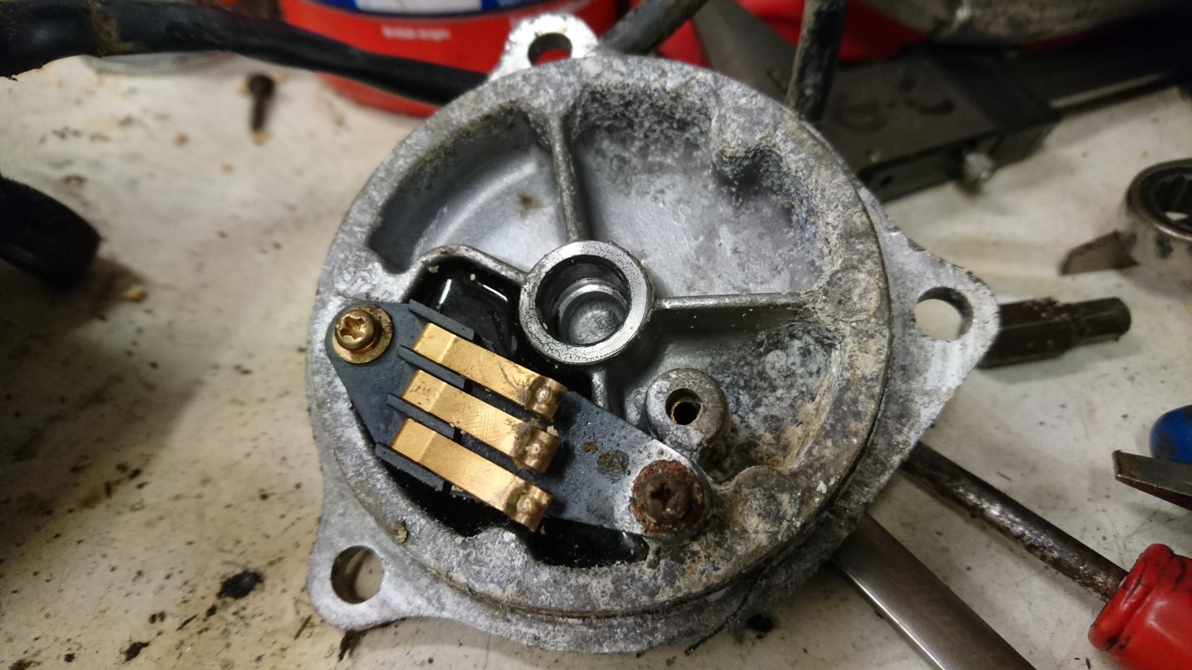

started having a look today so here is where i am
tested 4wd button works fine
fuses tested all ok
ADD relay under footwell not clicking when engaging 4wd button and no light on dash
good vacuum from engine and pipes to both VSVs and down to ADD unit on front diff are in good condition
swapped vsv hoses round and ADD unit engages and disengages when swapped back
had a quick test of the relay and working correctly but 4wd button has no influence on relay either on or off
when driving and engaging 4wd button 4wd light just flashes and beeps at me
im thinking it may be an ecu controller fault within the 4wd unit itself or maybe the transfer box motor on the back maybe but not sure just wondered if anyone has had the same symptoms before on there surf ?
any help or pointers will be gratefully received !
