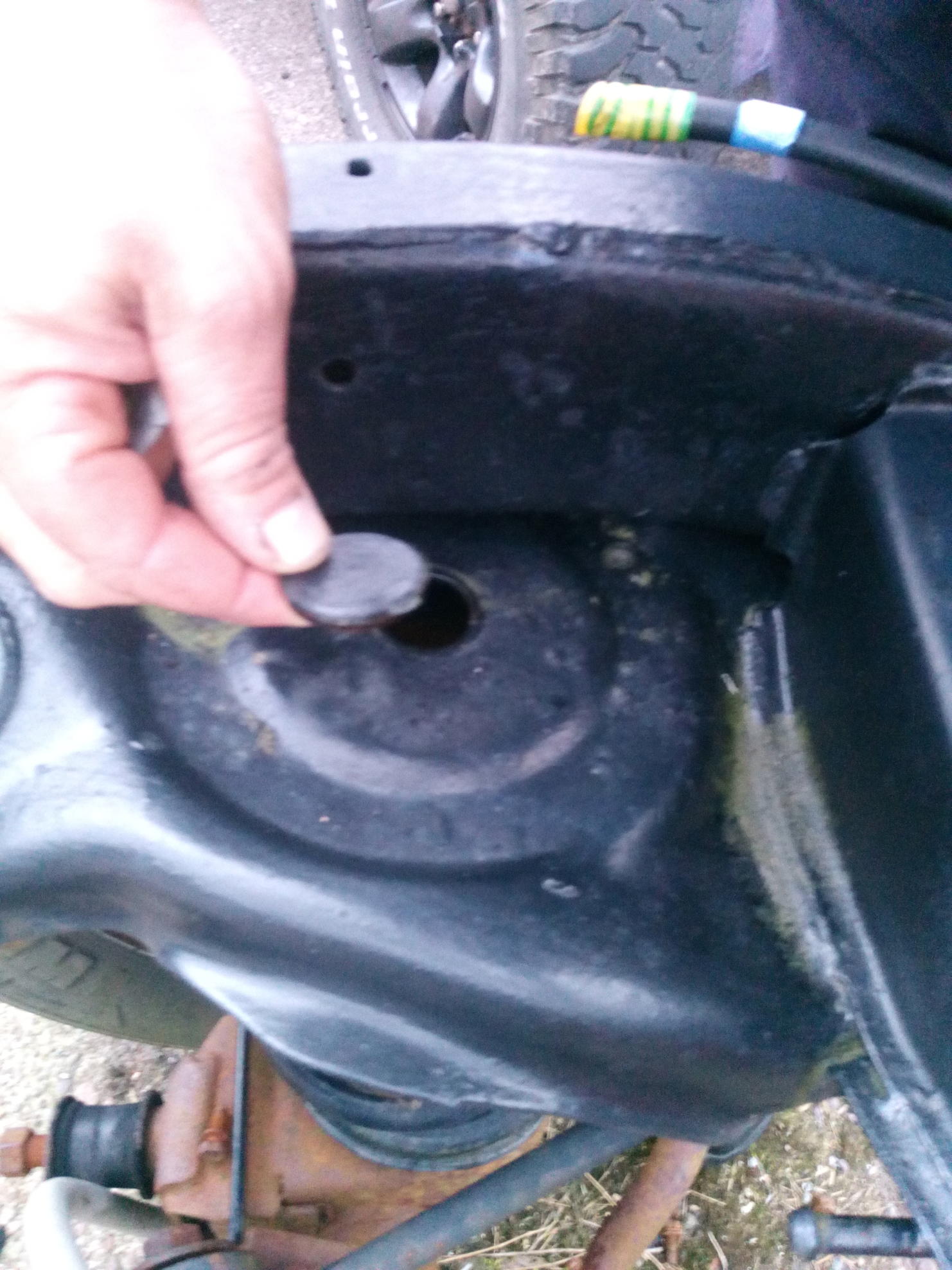

I'm pretty sure there's a captive nut welded to chassis for the bolt, so see if you can remove the bolt or whatever remains of it and see if the nut is ok. If not then maybe you can replace bolt and nut if you can acces that part of the chassis. Don't know offhand if you can, but will check mine sometime.
Nev.
hi, i just got to see this, yes, its an easy fix, but you will need to remove the spring to do what niftynev had said, on top of the chassis there is a plastic grommet that you can remove, and you can spay some oil to the captive nut,
i will go out in amin and take a pic of what i meanthe wolf is always bigger when you are scared!!
