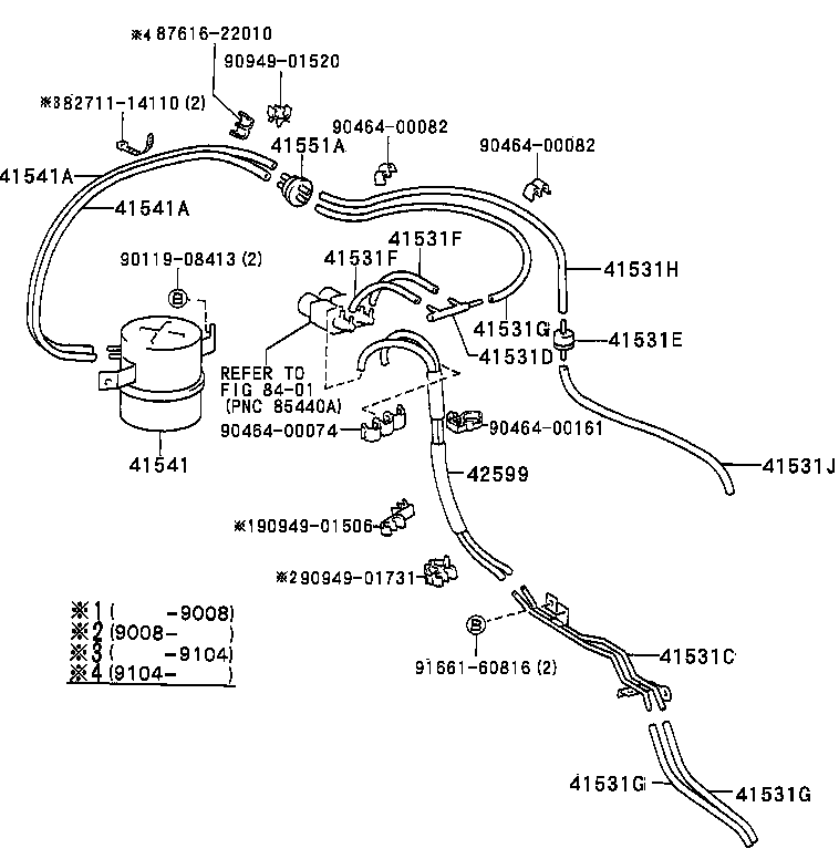

                          Regarding blocking of the vacuum pipes, is that just a case of a screw or bolt with sealant screwing into the end of pipe, for a basic quick fix?
                            if you trace the vac hoses back there's a tank with some valves in the OS wing that can go...keep ffollowing it back till you get to something that's not ADD related and block it off there...
                            I've not looked but you may find you can loop a pipe back on itself. Check it out and fill us in chap.
