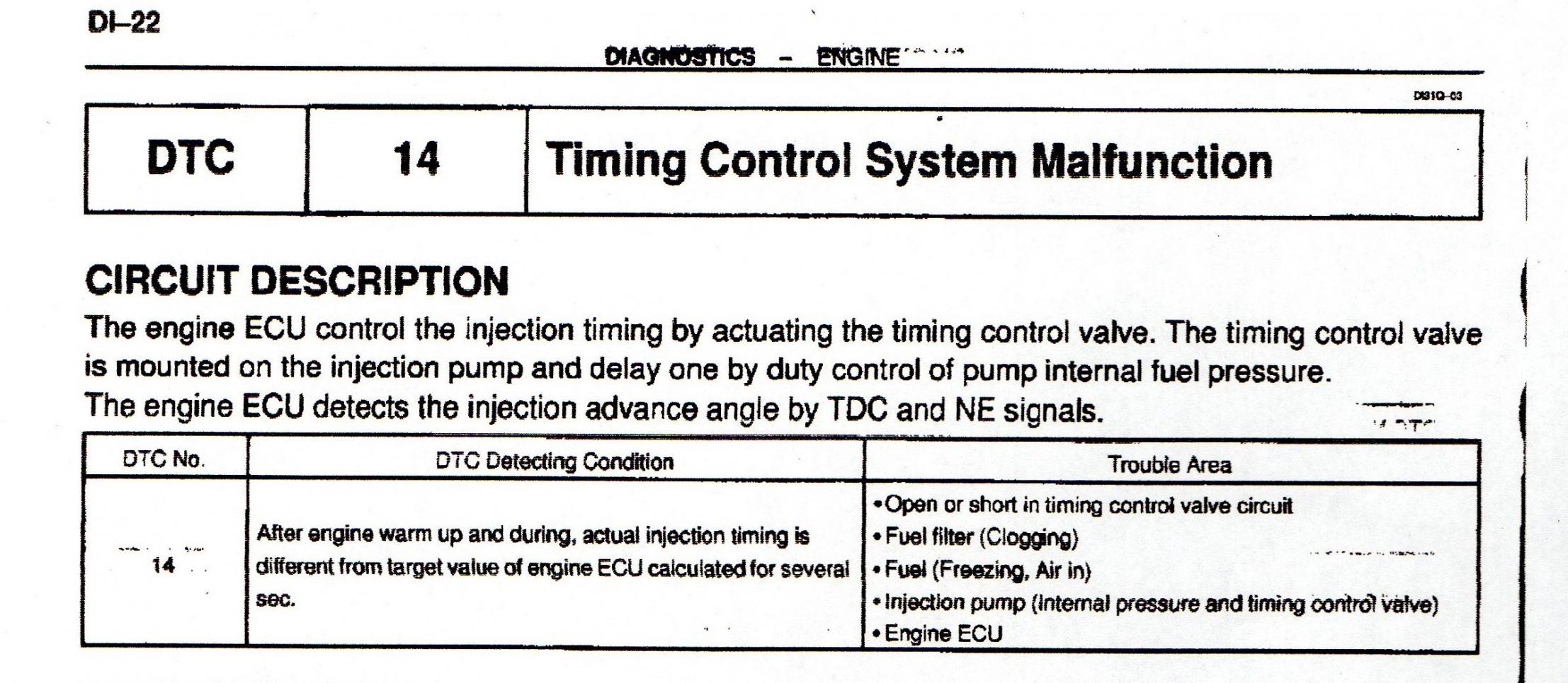

      managed to find out how to get fault codes
      and if i'm doing it right the code is 14 that is flashing,
      theres a flash a pours then 4 flashes. this is what I found
      when I downloaded the 1KZ-TE engine manual . I did
      change filters as soon as I could , the engine light has come on
      once moor since so I don't think it can be the filter it seems
      to only do it when I boot it foot to the floor not that often but
      some drivers you just have to get past.
      will have to cheque the timing control valve as it shows further in the
      manual.

                    ive got all the codes from a download for kzn 185 and code 14 / seams to be anything from blocked fuel filter to engine ecu I have changed all filters
                    and checked timing control valve for resistance it should read 10-14 homes
                    my first reading was 9 next couple of readings was 10 homes so its borderline I think.( but who can pin point it better),a new timing control vale is £285 from Toyota a lot to shell out if its not that . recon pump £550 Cheapest ive found. second hand ecu £200 with no guarantee no return .so it could be an expensive way to eliminate . I have read another post about ecu doctor
                    who can check the ecu for a £35.00 .
