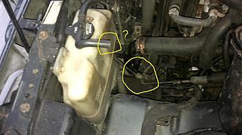

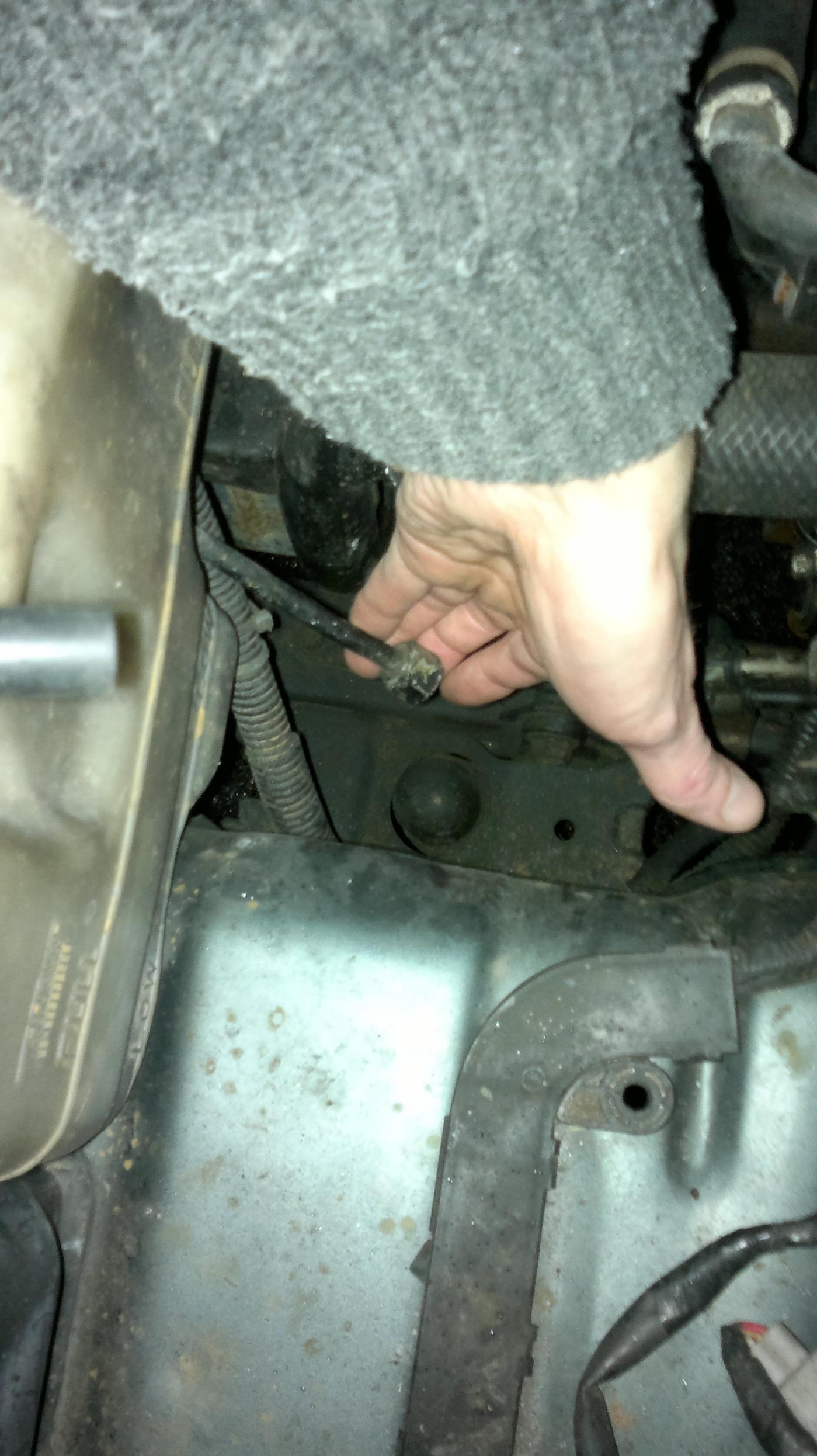

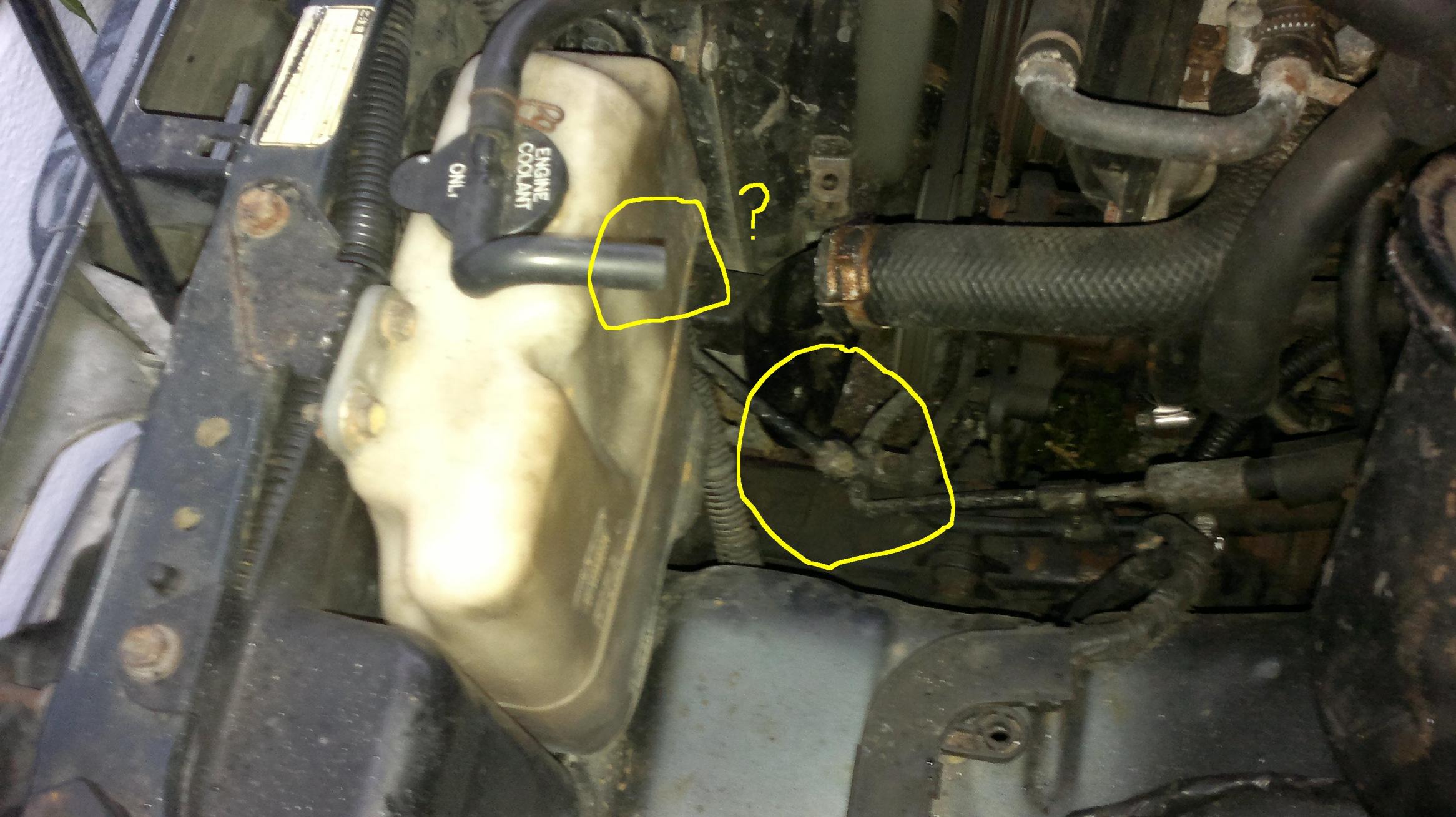

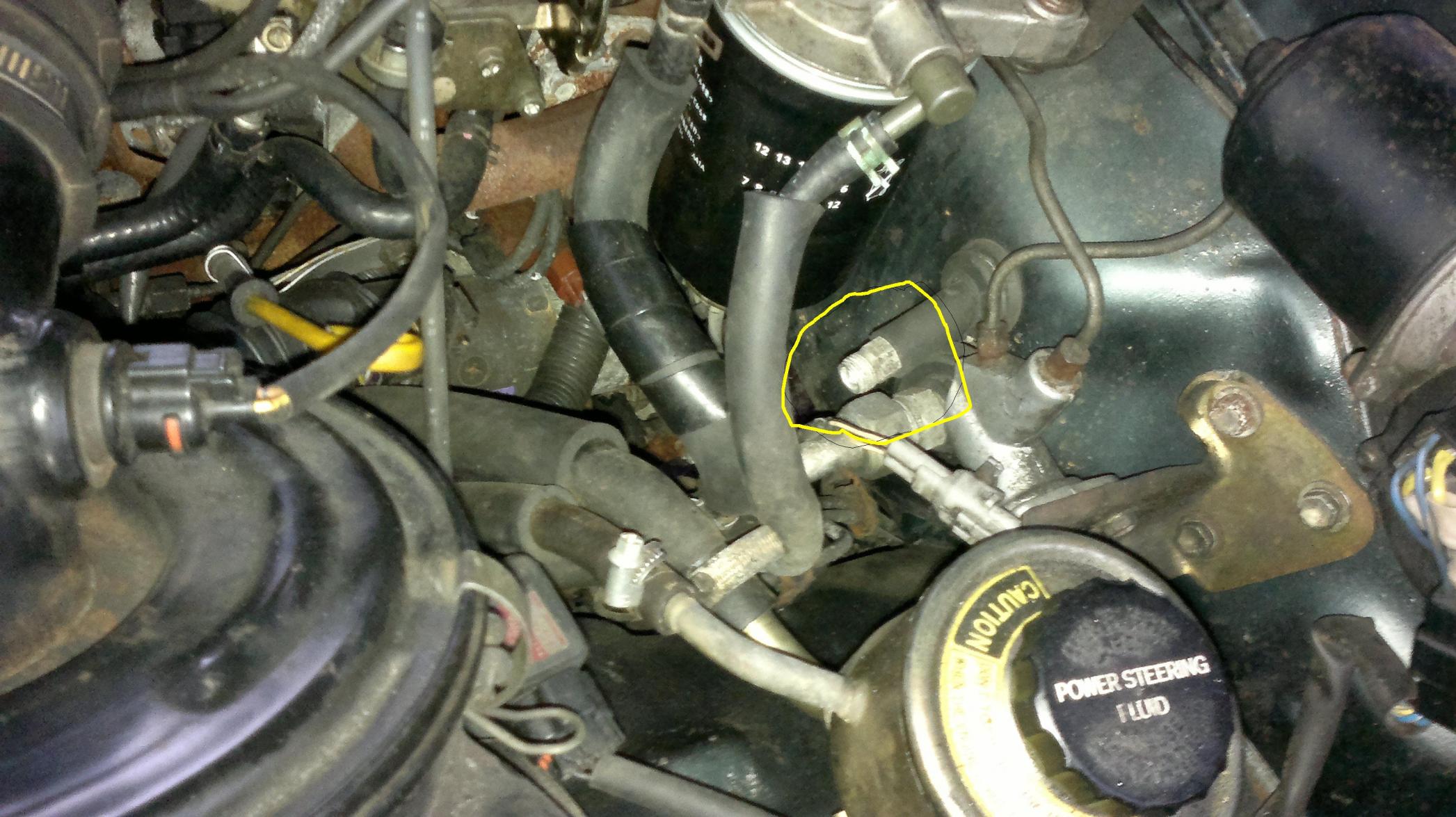

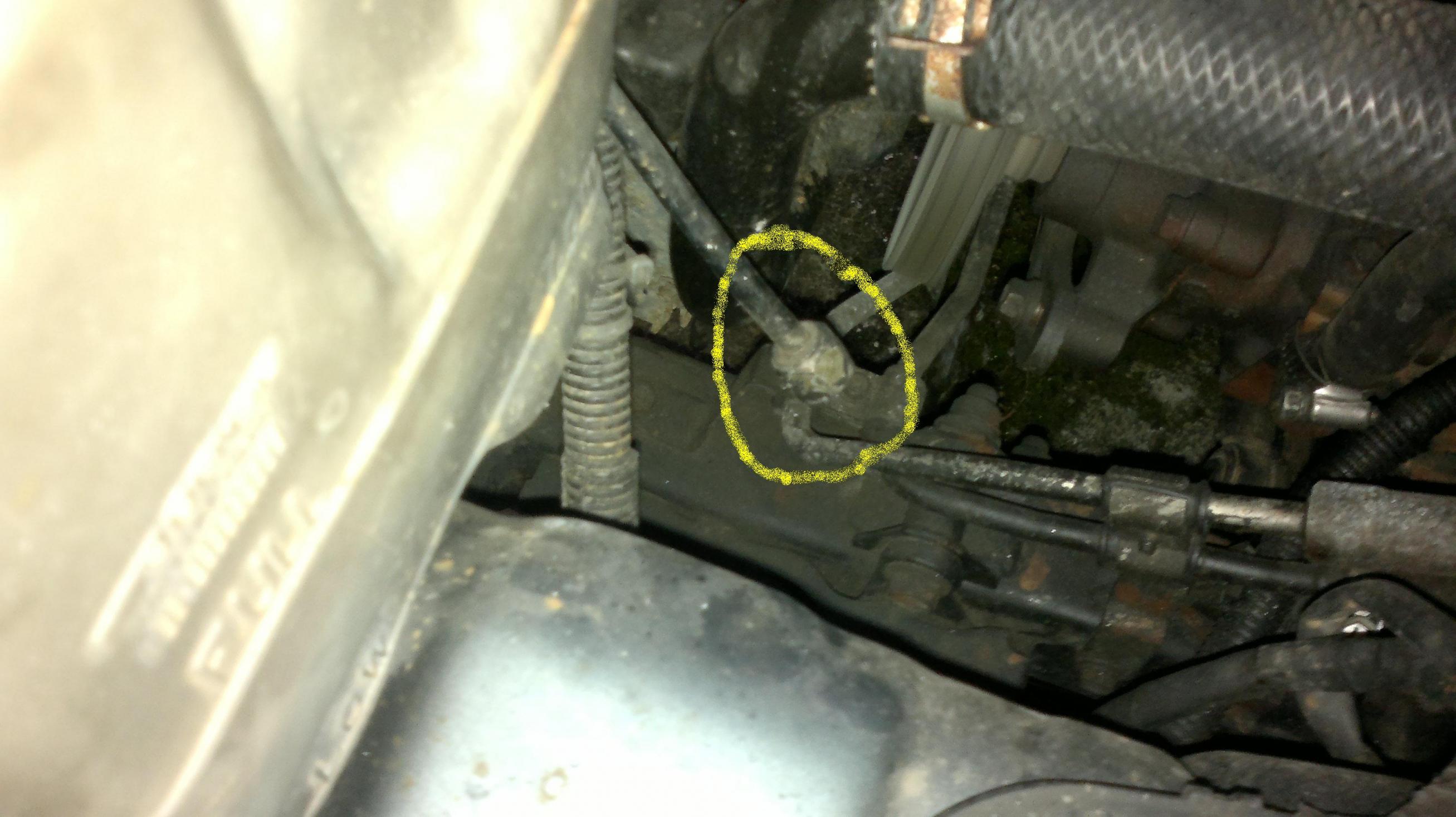

                Also take a look at these photos, they may have something do to with the coolant system? I have a feeling something is not quite right.
                Regards,
                Kurt
                  All of those parts are to do with the A/C.
                  The next thing to check is the heater hoses where they go through the bulkhead, give them a squeeze and see if they feel crunchy inside. If they are then a heater matrix flush may be needed.
                    Yea, your right, its the pipes, they feel like they are full of crushed ice, there blocked up alright. How should i proceed with the matrix flush out??
                    Also on the separate issue of the photos and the A/C, am i right in being concerned about those pipes that look like there were disconnected from something??

                        Just bear in mind that those pics relate to the 3.0 and not the 2.4
