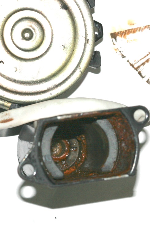

    I took the tailgate motor apart and all good except water got in and rusted the rotor coils at bottom, dont suppose there's any point in trying to soak it in anything and let dry, wd40 and try it again?
    (it was short circuiting when I tested it on the battery terminals, was sparking on terminals but there was water in there not just corrosion)
      Talking to myself in a public place is a sure sign of madness but I'll keep the thread going as I go

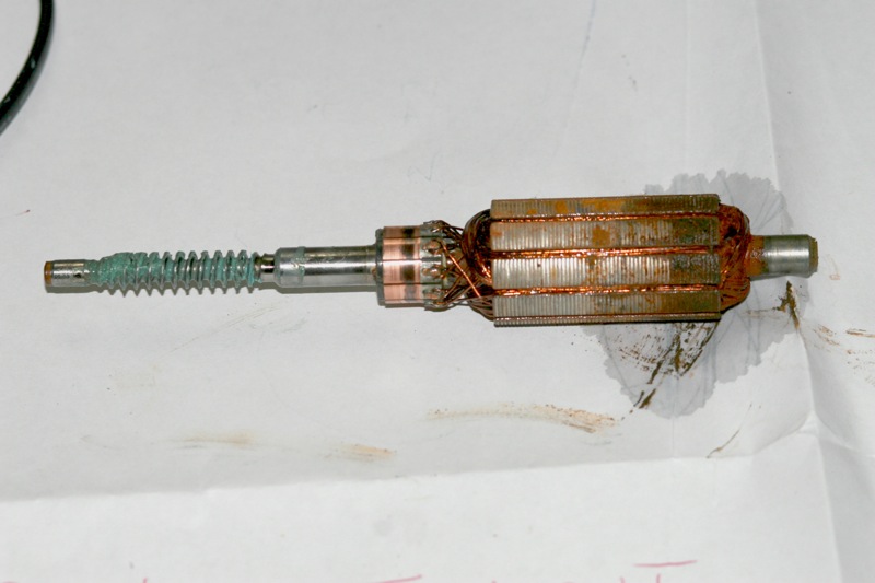

      Here's a couple of pics of the gunk inside where water had collected inside the tailgate motor rotor / stator housing
      Well the pics speak for themselves, the magnets aren't too dirty, but the coil and conductors are and plenty of rust all round, it was all wet, water dripped out when I opened it, so I'll try to clean in the morning with gt7 and a toothbrush and see if it works
      The brushes are ok, still got plenty in them but they could be replaced easy enough if they weren't
      fingers crossed....
        ps the plastic gear drive was a crap production by Toyota - surprisingly - but I'm hoping it will work for a while, oh and the capacitor / condensor may need replacement... well see
