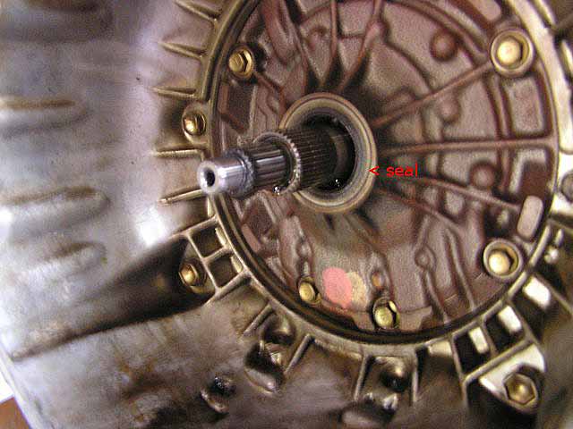

              Not trying to thread-jack, but it sounds like our Surf is leaking transmission fluid from the same place - the joint between the auto box and the engine. Can I assume it's an engine-out job to repair?
              An unmuddy off-roader is an unloved off-roader!
                No, transmission out job.
                This is the likely culprit if it is definitely AFT thats leaking.....
                  Thanks for the tip, Bushwacker, I'll investigate it if I can get my hands on some heavy-lifting gear!
