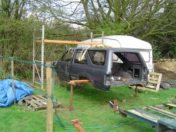

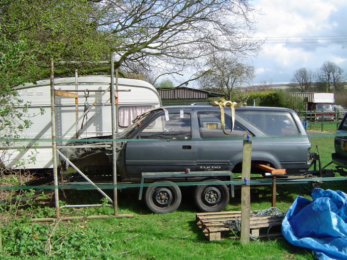

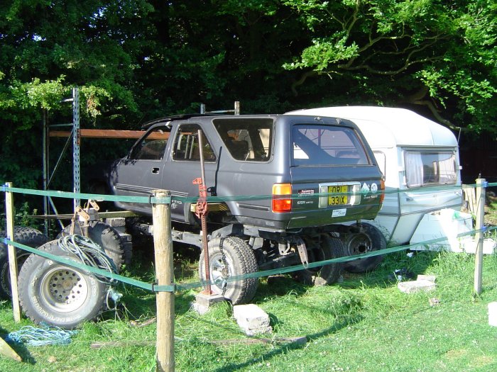

              Its pretty easy TBH, but takes awhile to disconnect things. I did it like this...

                      Tony, Thanks for the pics.Thats kind of what I'm thinking,making up a gantry from scaffold (which I have lots of!),and get a friendly local farmer to lend a tractor to do the lifting.
                      What do you guys think the body shell weighs?? I'm thinking about 5-600 KG
                      If I disconnect the a/c pump,and lift that with the body shell will that save the a/c gas??
                      PS Tony I was wondering why you would put that shell on a chassis,and then I realized,2 door!!
