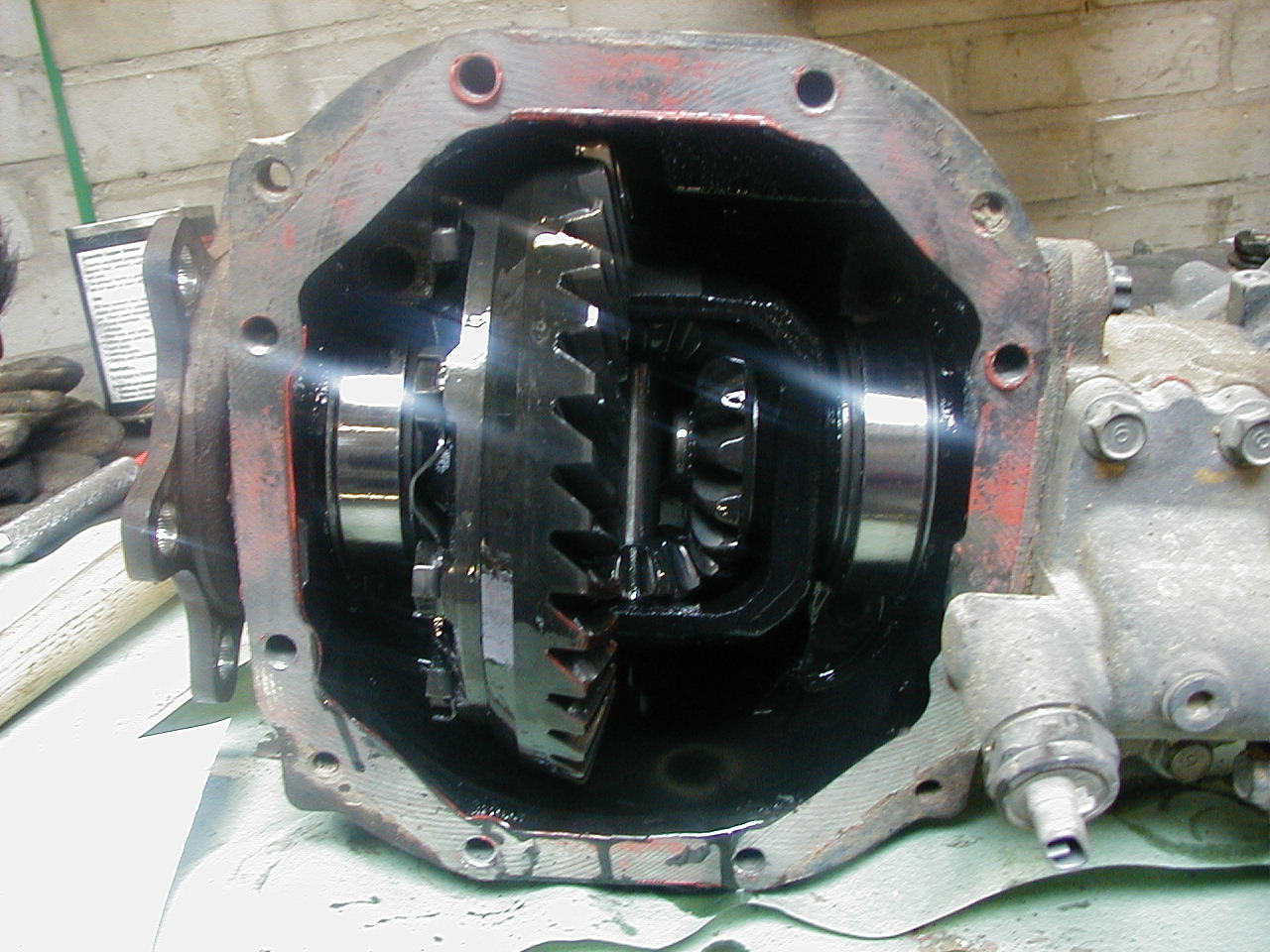

    Basically you need to get the shaft out of the diff. there is a spring clip inside the diff holding the shaft in. Just gentley lever the shaft outside of the diff and replace the seal.
    For the full description try searching for my run down of the job. If not look at the pic attached. Below for a peek into the diff.
