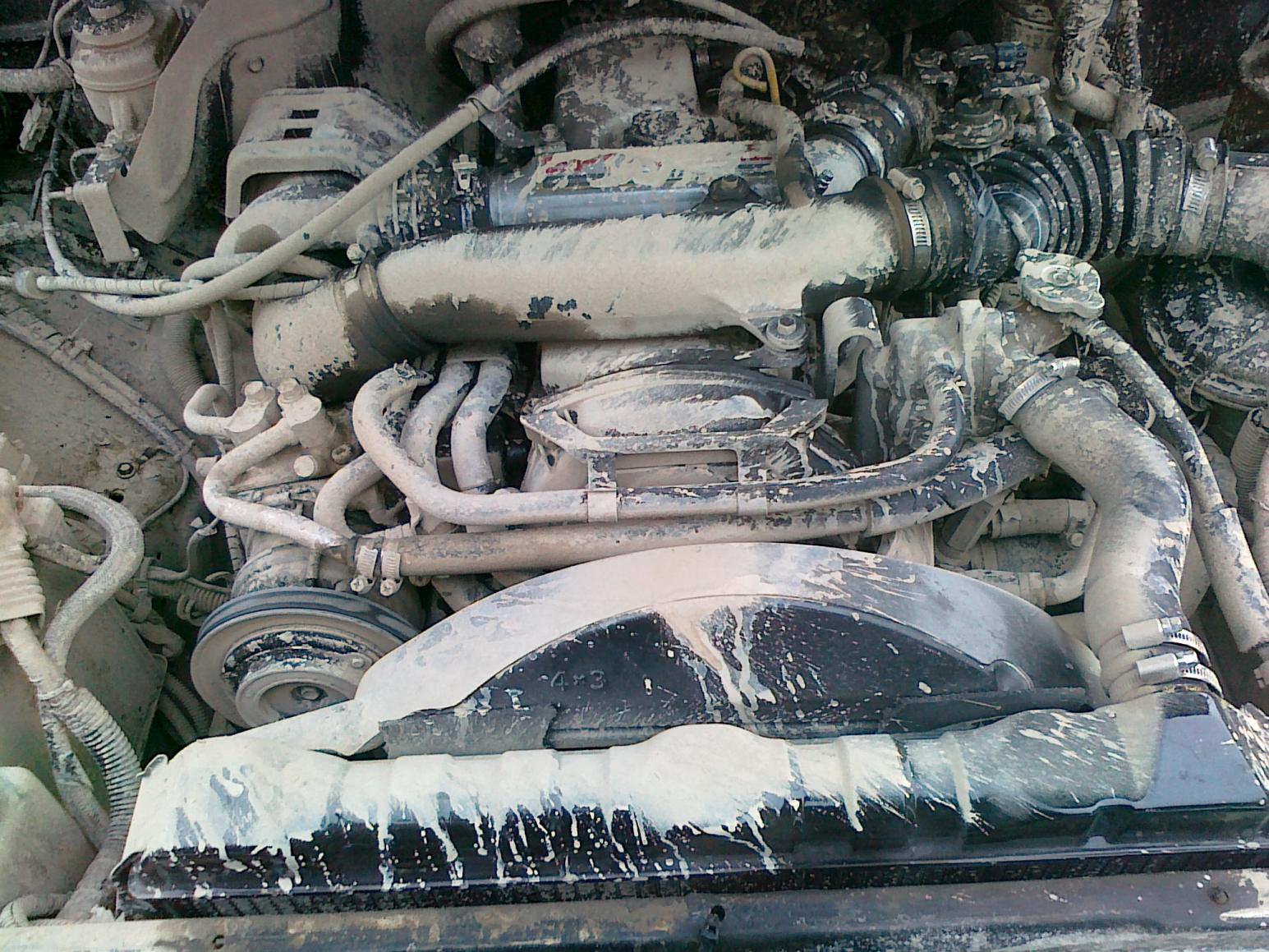

    Ok Lifted bonnet to start the blowing exhaust check,which actually was a collapsed intake hose...
    Saw how muddy it was and as I was cleaning the truck anyway gave the engine bay ,front axles and rear axles and wheels a real good clean with the jet wash.
    Bodged intake hose and went for a drive.
    Brake pedal went straight to the deck and brake lamp up on dash.
    Brakes do sort of stop the truck but not really feeling the foot to the floor style.
    I am personally hoping that the issue is with the soaking I gave it and with the heat of the engine it will dry out and be working ok ,assuming this is not the case any pointers as to where I should start first?
