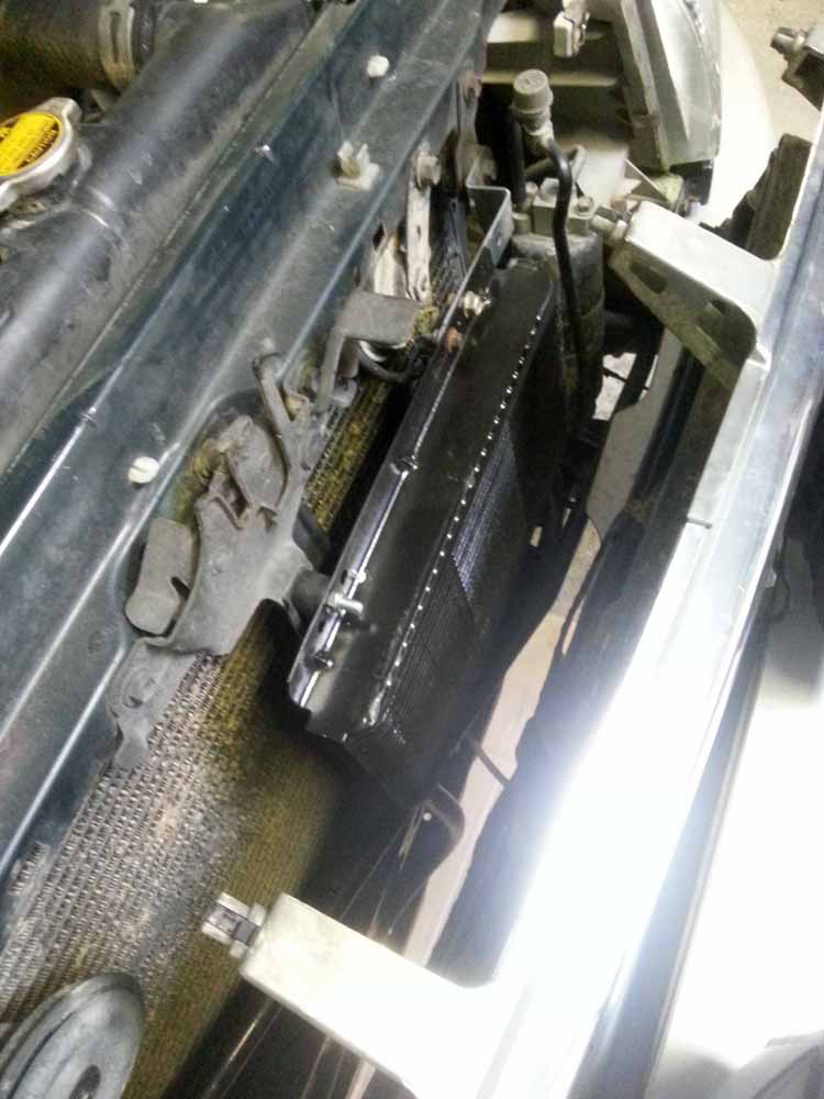

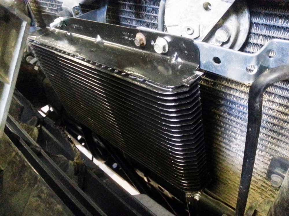

          I got an atf rad from Summit Racing last week (recommended by Dara; it's the same one he used in his surf). Below is where it was fitted; air will flow through it, so it's not causing a huge air blockage to the rad, plus it is protected behind the bumper and isn't sitting low in case I bounce over something.

                      @ Dieselboy; glad you found them useful. The only mod to the surf was to saw off one of the arms holding the grille, but the grille is still solid on the other 5 arms. The cooler is protected by the grille and bumber, and is high enough that it won't (shouldn't) get a smack from underneath if I go offroad and bounce around a bit. My mechanic used rubber mounts so that it wouldn't rattle either. Dara had warned me that I'd need extra hose to fit it properly, and all of the hoses hide nicely above the guard underneath.
                      Fitting took my mechanic about 1.5 hours, and all he removed was the grille (I've seen posts somewhere about people removing the entire bumber). Also, the cooler doesn't block airflow to the rad as the air will pass through it.
                              The main reason I've prefered fitting them behind bumper vents and off to one side is you already have the A/C rad fitted in front of the main rad, so end up with 3 rads stacked inline, with the coolant one right at the back. And seeing as the main reason for fitting it is to cure engine overheating issues when its working hard seemed better to fit it away from the rad a bit.
                              Yes you'll still get airflow, but it'll be very hot air after going through the AFT cooler, and the A/C condenser before hitting the rad.
                              Also in the hose run is shorter and not up so high.
