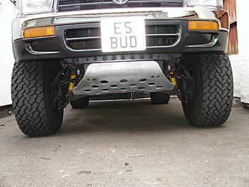

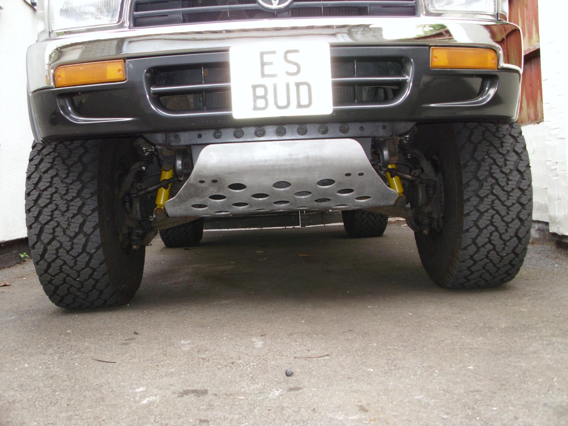

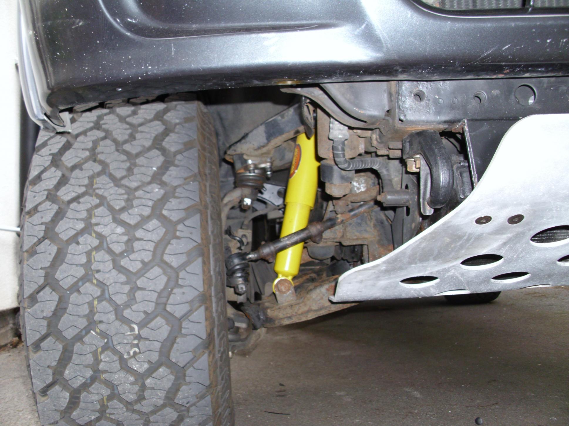

            No, not at all, they look pretty much the same angle as the upper arms,
            if anything only slightly steeper.
            Couple of pic's showing angle's of control arms.
