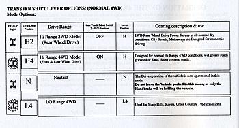

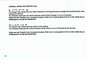

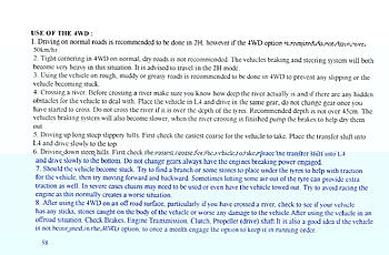

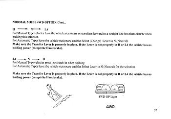

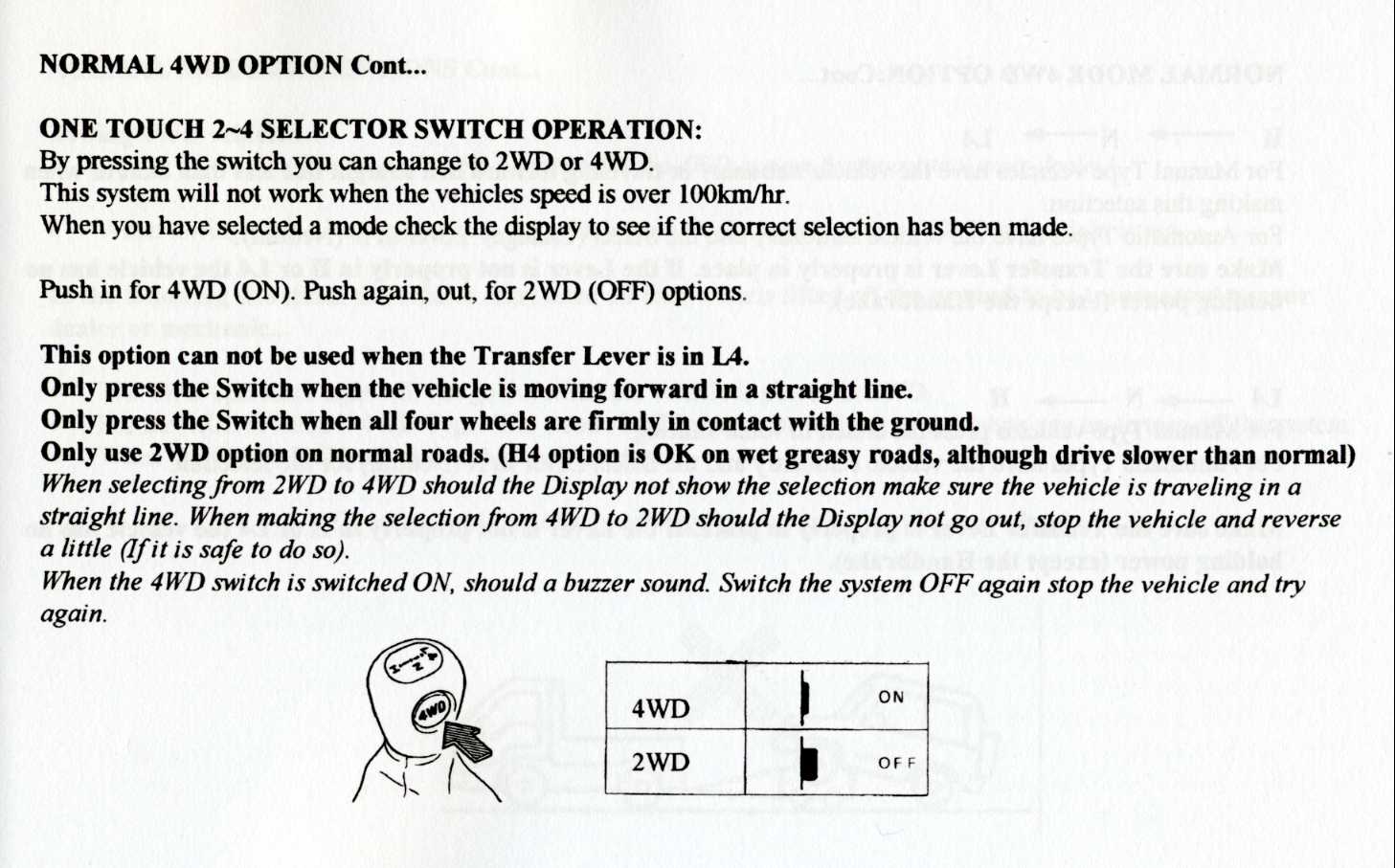

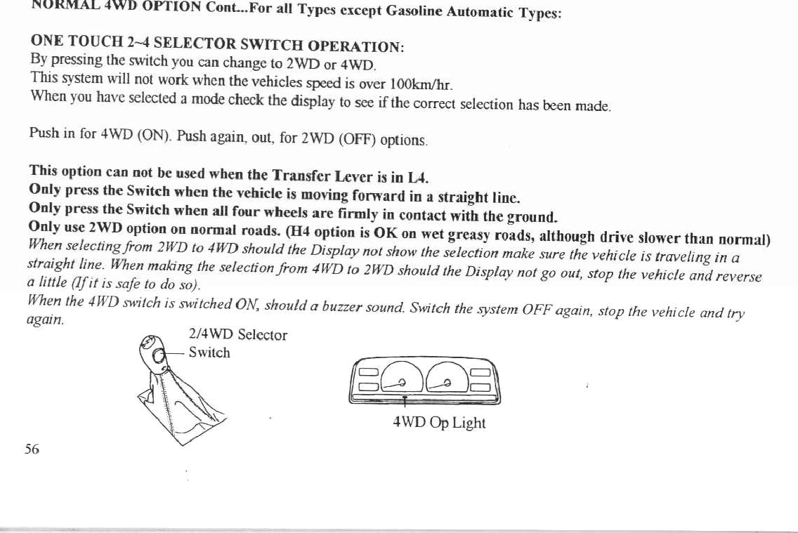

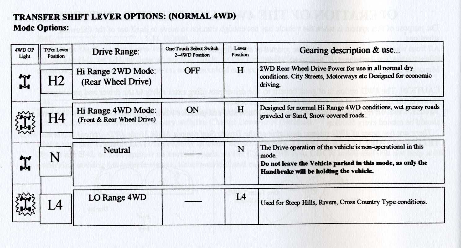

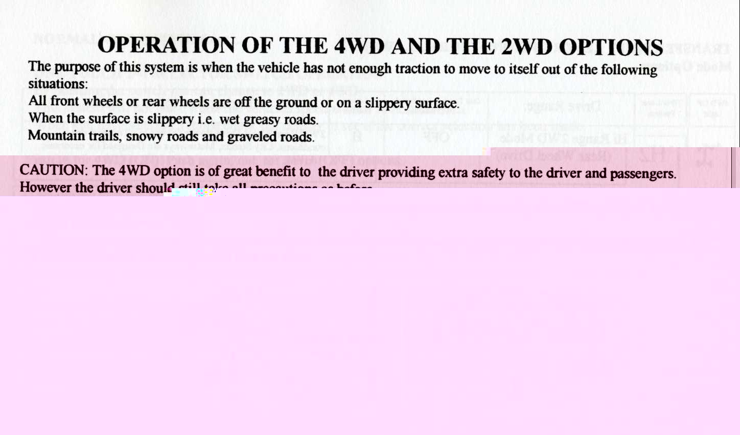

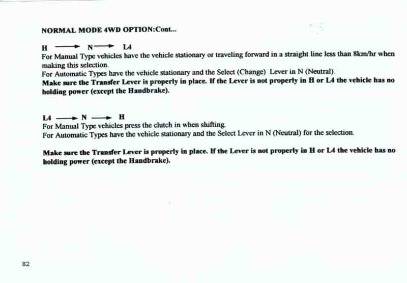

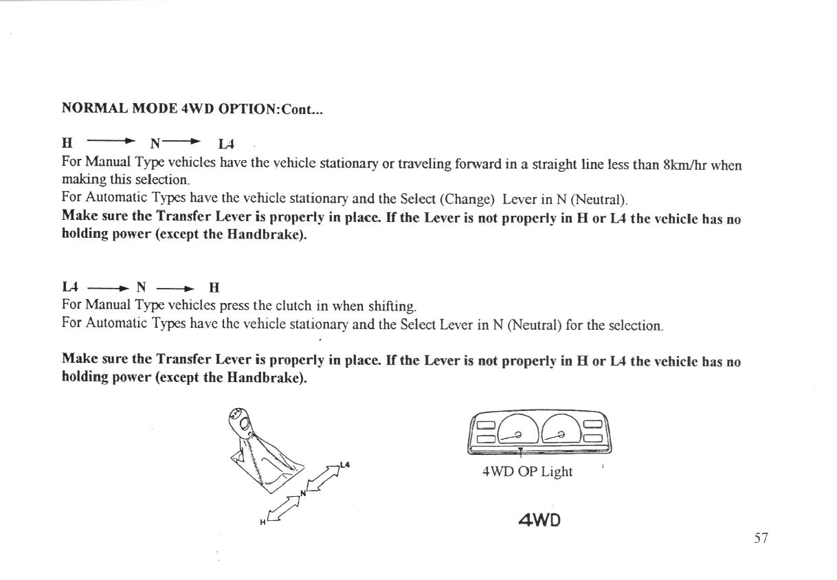

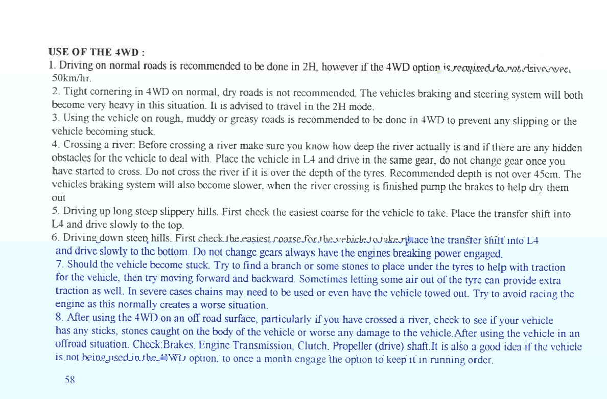

The book I got with our car is different from both Tony's & Jock's..... will scan some pics of my version 2morrow - therefore confusing everyone totally !!!!!!!

Tony's is a UK 4Runner. The transfer selection is different on that.
On Mine (probably the same as yours), change into 4WD up to 60kph using the button on the side of the transfer lever. Can't use this on the road, only on loose surfaces otherwise you get Diff wind up. You can't change into Low ratio without stopping though. Stop the car, engage Neutral on the Autobox, move transfer lever from HI to LOW (2 notches forward, i.e from high to neutral and neutral to LOW).
