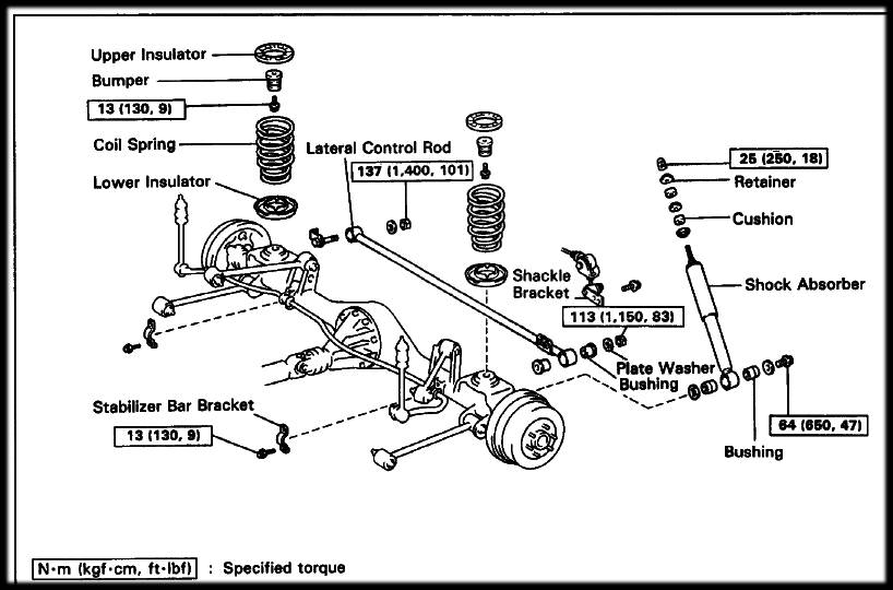

Ok everybody, I've done a pretty thorough search on here and the Aussie tech site and I can't find any torque wrench settings........
I've just changed rear coils on mine.......
Can someone please point me in the right direction or give the torque settings for rear suspension and axle.
