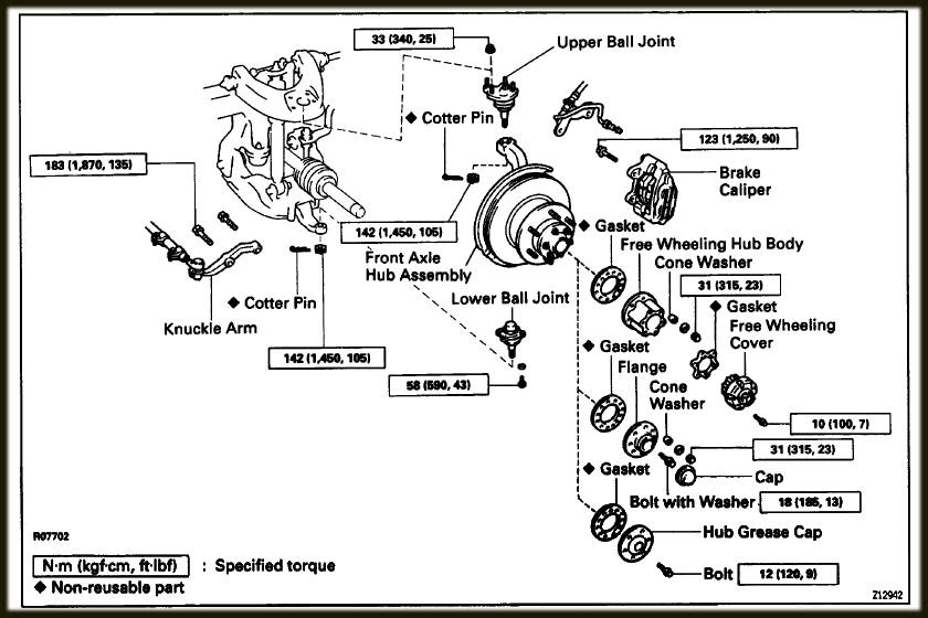

I'm also looking for confirmation on the torque settings, according to the Max Ellery manual (page 294) should be:
Ball Joint attaching nut: 142nm (if they are the 4 at the top, I think this is very wrong)
Upper suspension arm ball joint nut: 142nm (castle nut - possibly right - although seems a bit high?)
Lower suspension arm/ball joint and bolt and nut: 58nm
The Haynes says (pg 10A-2):
upper balljoint to upper suspension arm: 30nm (sounds good? for 4 at top)
upper balljoint to steering knuckle: 108nm (castle nut)
lower ball joint to lower suspension arm: 127nm (sounds high)
Lower ball joint to steering knuckle: 142nm (castle nut)
What should the top 4 ball joint to suspension arm bolts be?
What should the Top castle nut be?
What should the bottom 4 bolts/nuts be?
what should the bottom castle nut be?
