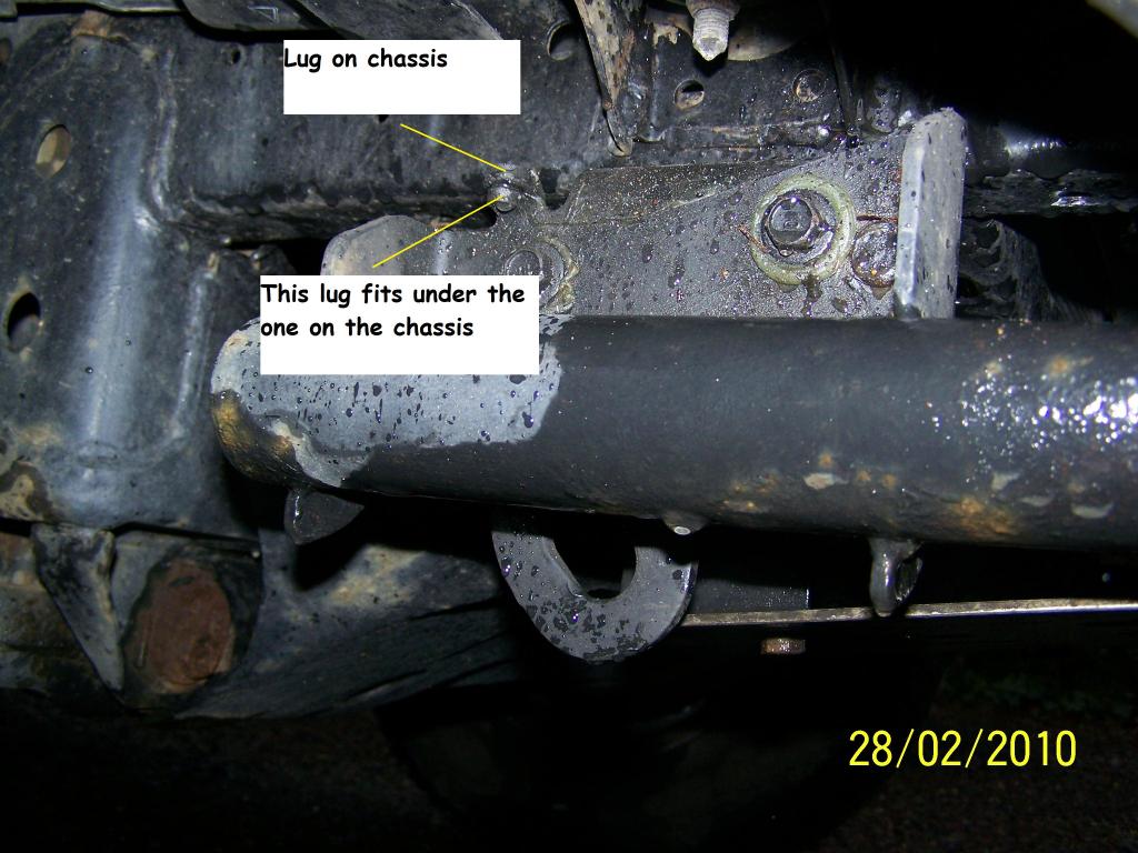

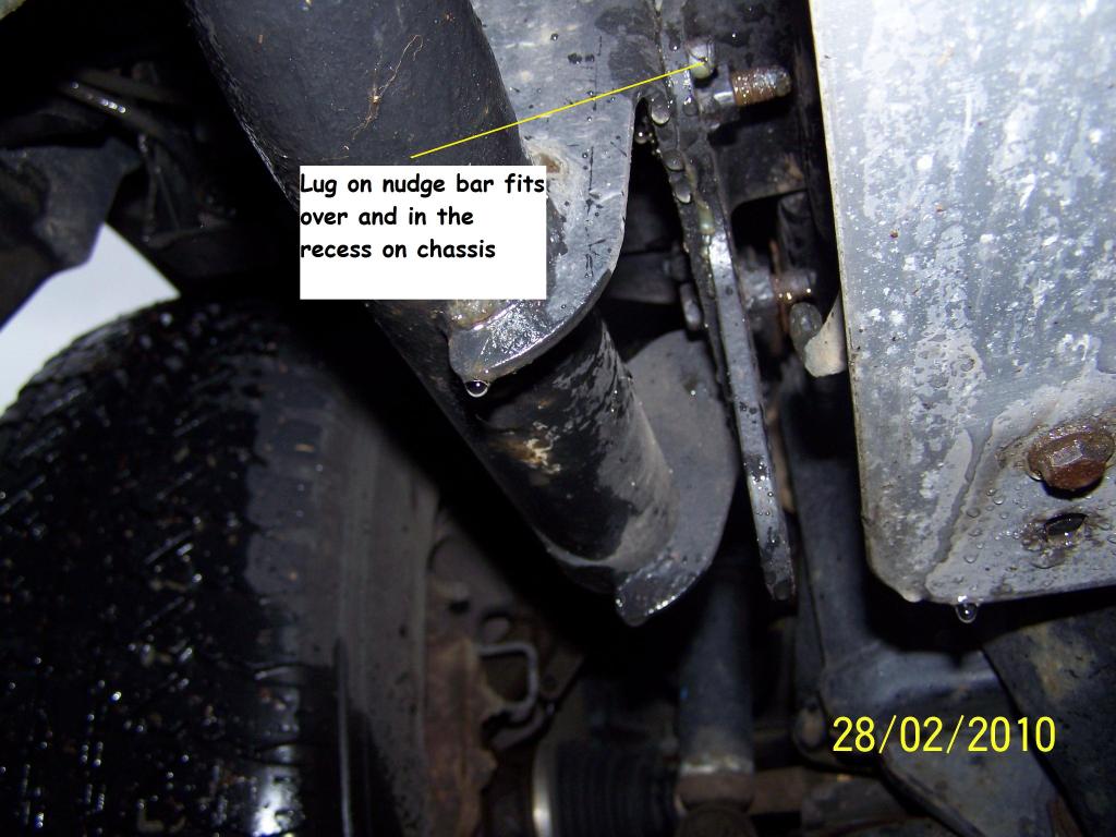

              Hope these pics help, the lug on the inside needs to be placed first so you will have to tilt the nudge bar up to get it in i.e. top of the bar where the lights are wants to close to the truck, if that make sense.
              Put some grease on it, helps to make it easier to slide on.
              Just realised the first pic states the obvious a bit but you get the idea .
              Neal
                Thanks a lot lads, it seems that there are two brackets I'm missing. They're the ones numbered 52441 and 52442 on the exploded drawing on Nev's link. Fair play to ye lads, and Neal special thanks for the annotated photo's!
