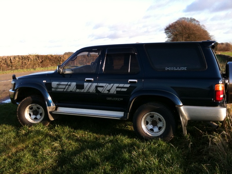

                Thanks for all the advice. I bought new runners for the rear window and installed them myself. The old ones were rusted away. I got autoelectrics in Swindon to diagnose the problem with the electrics (broken motor and relay / control box). I got sourced both of these items second hand cheaply and got autoelectrics to install them. Once they were installed everything works smoothly, even the rear wiper is now working. Only thing that doesn't work is using the key to raise the window - I have to use the dashboard switch. All in all I paid considerably less than the substantial discount I negotiated off the asking price for the Surf, so I am quids in.
                Amusingly I gave myself a scare the other day. I went to the hills with kids, dog, sledges and skis. After getting kit and dog out of the back, I couldn't get the window to raise up. I convinced myself it was broken - ideal timing in the snow - but of course it was because I had put on the window lock because the children were playing with them during the drive...
                I am loving my new truck, especially in this weather. Could have spent a grand more and got a Gen 3 with ABS, but happy with the Gen 2 - just drive a bit more carefully on the snow and ice.
