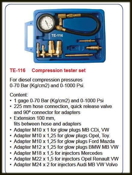

Just been quoted £70 for a compression test on the truck. I can buy a tester for that but need to know the thread pitch of the glow plugs. I can measure it at work tomorrow but want to try and get the tester by the weekend if possible. (order asap - ie: tonight
