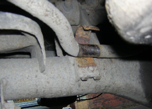

Just began 2 get similar clanking noise...had good look underneath and found roll bar mount on axle had broken. See PicOriginally posted by peckstaIm getting a clang noise when driving over bumps like drains etc in the road. I spoke to a guy at Rough Trax (www.toyotahilux.com) and he said its the drive shaft.
as 1 had gone thought id replace both at the same time aswell as new rubbers...if 1 had gone the other wont be far behind.
took 2day for toyota 2 get in stock but easy to change. £17 for two brackets and £13 for two new rubbersBEWARE OF THE REAPER
