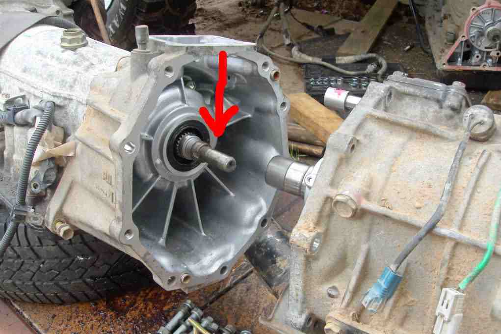

Drain transmission fluid.
Remove gear shift surround.
Remove four bolts and lift off transfer lever.
Disconnect front/rear driveshafts from T/case.
Remove bolts that attatch T/case to transmission.
Unplug sensors.
Pull back T/case from transmission.
When re-fitting, take care not to damage oil seal on input shaft.
Unplug sensors.
thanks for that,bushy is it the 4 bolts or about 8 around the case banjo shapped?
