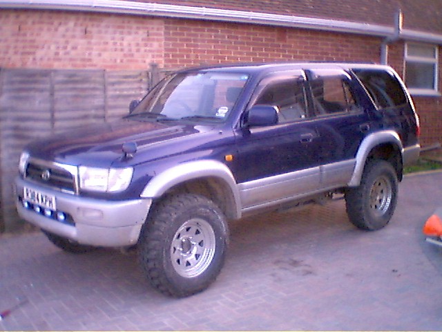

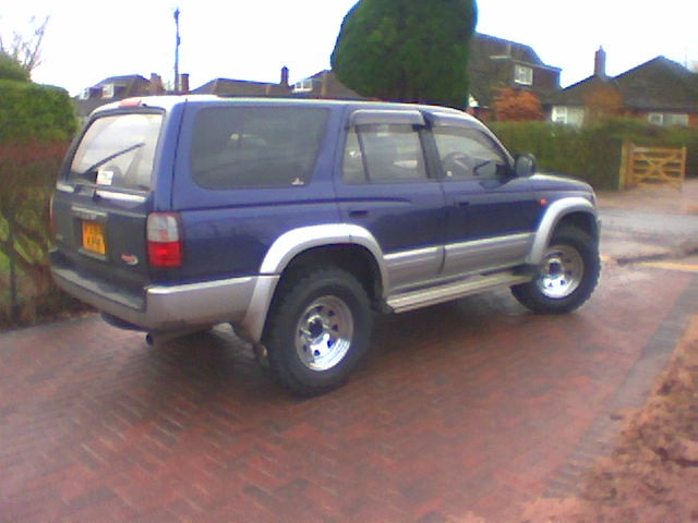

              before and after 2" lift with 31" tyres (265 70 16)
                Cheers Dabigman, pictures really help - doesn't look too much and i reckon losing the sidesteps helps too!
