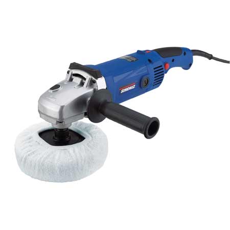

                Vince, when you are "cutting" what method do you use?
                  I use my polisher set at the slowest speed with a damp, white grade sponge fitted for the 'cutting' keep the sponge moving around the panel all the time until you can see it starting to dry out. Let it haze then buff off with a soft cloth e.g. brushed cotton cloth or yellow duster.
                  Then I apply the carnauba wax (E-bay) by hand and buff off by hand.
                  This is the machine I have, got it from MachineMart and the white sponge which can be bought seperately in different colours/grades.
