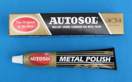

    Give them a polish with Autosol, it leaves a protective coating that lasts a couple of months.
      Not like roughtrax to sell shoddy parts, did'nt you get some sort of guarantee on them against rusting.
              do as bushy says then wipe with petrol,leave till completly dry,then a couple of coats of clear laquer,job done
