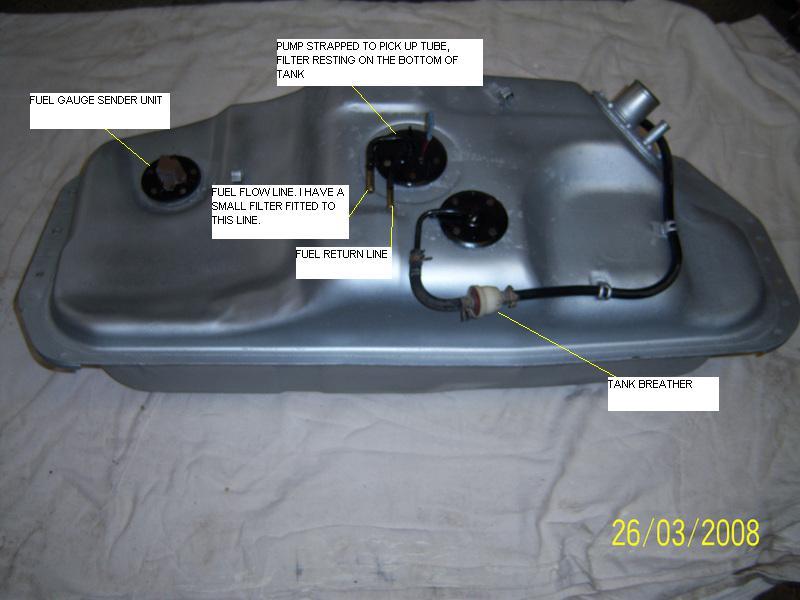

Using the pic below (thanks Bushwhacker) I have found the hose and pulled the bit that I presume is a valve of filter or summat and water ran out of the side of the hose going towards the filler opening.
Also my filter was fitted the other way round to the one in the photo. It has an arrow on it which in the photo would seem to imply that the flow goes from the breather to the filler opening. If this breather is to allow air in to the tank to replace the space taken up by the fuel being used shouldnt the flow be the other direction?
I dont really understand how this breather works as both ends of the hose seem to be attached to the tank (I was initially expecting it to be a little raised breather similar to the ones on the diff)
So how do I go about unblocking it? Do I need to somehow pull all the hoses and run something through them (not the easiest to reattach) and how do I clean the bit I have puled off? I can blow and suck a very small stream of air through it but it doesnt seem to do this freely.
