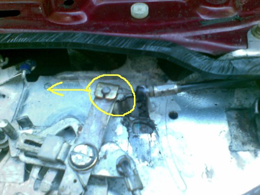

DoorPic1 shows how the tailgate safety latch works to prevent the tailgate from openning (located lower centre of the tail gate). If you reach in and force the mechanism in the direction shown, you should be able to raise the handle and then drop the tailgate.
To make it simpler I wound the window up around half way first and reached over to force the mechanisim.

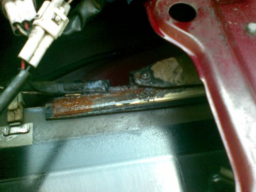

DoorPic2 shows the spots that need to be lubricated.
Lots and lots of greese all over these two points (one either side of the window). It seems that water collects here, causes rust and prevents the mechanisim moving freely.
Whilst your in here, using silicone lubricant, lube the insides of the two window guides. I also went happy with the grease on anything that looked like it moved.
