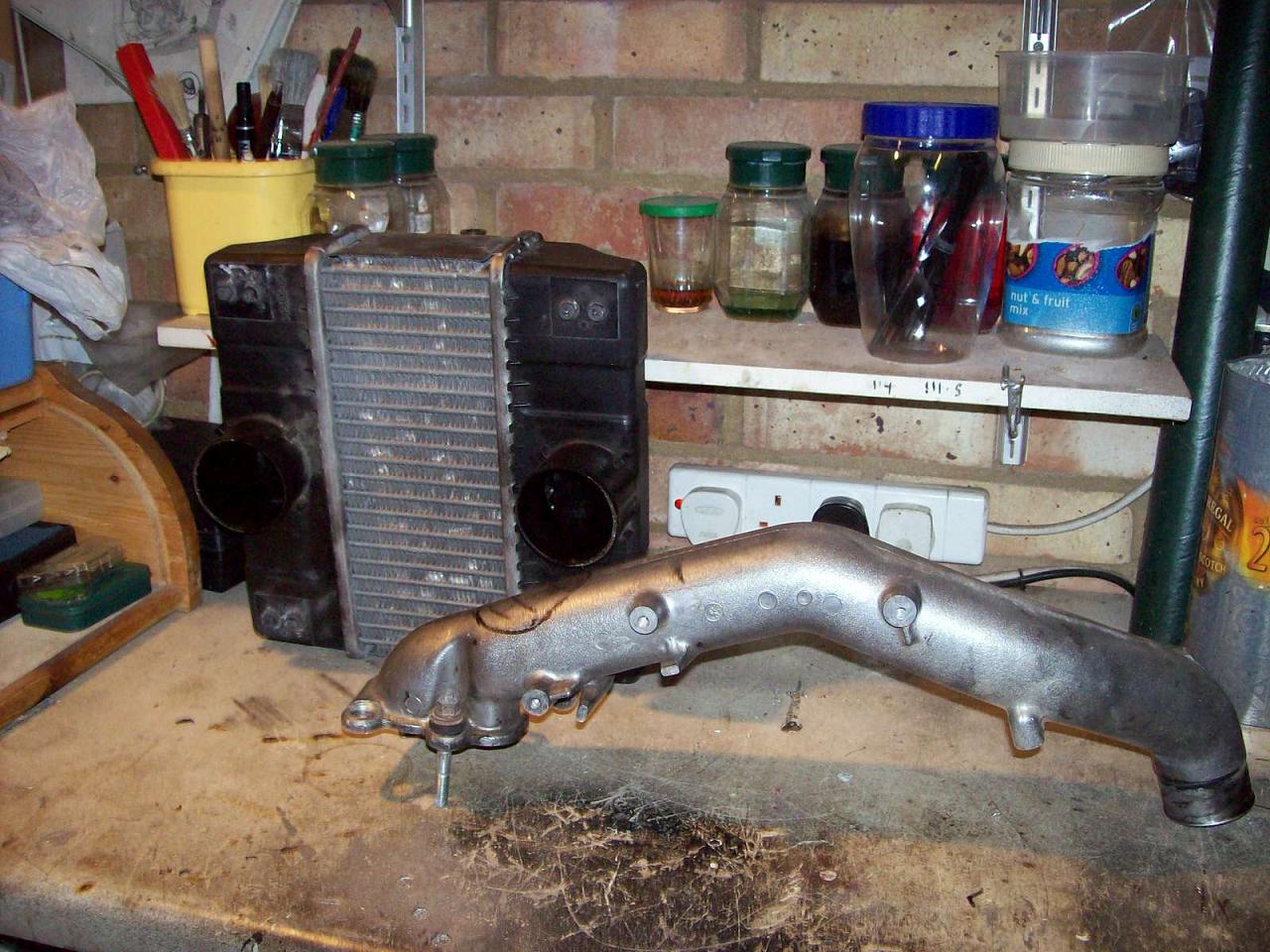

What is the pressure in the ATF system? I am putting my cooler where the drivers side indicator was, and opening up the bumper a bit to suit.
If I fit a bleed nipple on the outgoing pipe, can I bottom feed the rad, or is the pressure not high enough to fill the rad properly?
I imagine I'm better off top feeding it as then I know that the rad will be definitely be full.
