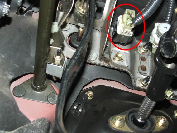

      It's the one behind the dash up on the brake pedal bracket marked "Fuel Pump Relay"
      Nev
        Here's a pic.
        Nev

            add
            Nev
            cheers thats logical .
