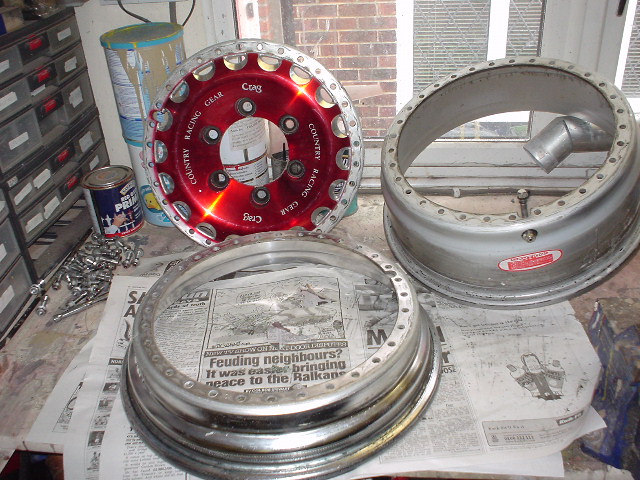

        all depends if there three or two peice rims me old mate, have a good look at the mateing set up where the small bolts are, if the rim is visable both sides chanches are their three peice, if so you'll need to have the tyres removed,
        two peice, you can just remove the spider fron the back but either way i'd let the air out and remove the valve, two peice ya dont have to worry about resealing but three peice ya do,
        if so just get a couple of tubes of "SIKA" auto grade sealant, about a tenner a tube, (like the bathroom stuff but a lot better) and dont be paying £60 a wheel like i was quoted just to reseal em, just make sure you clean up the mateing surfaces with a wire wheel in a drill and a wipe ove with de-grease'r, smeer the sealant round the mateing faces and bolt together, then spred a good bead round the inside rim, allow a couple of days to cure and then apply some more, smooth it over with a plastic spatual type thing, (like ya get in tins of body filler) and when it's fully cured ya can have the tyres refitted,

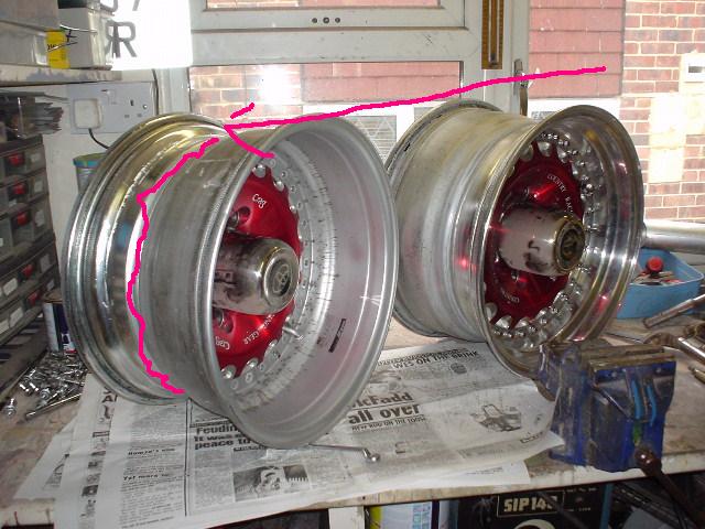

        i take it their alloy? in which case you can clean and polish em yourself, just means hard work, and dont relaquer em either, just a polish once a year with car polish will keep em good, i got a nonferrious polishing kit from ebay for the initial clean, then autoglym and aint touched em since, still shiney,
        laquer always goes yellow or flakes off, you'll find the original coating aint laquer, stripper dont touch it, it's more like an electricly apply'd coating, a bugga to get off, only way i found was a brass wire wheel in a drill,

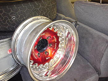

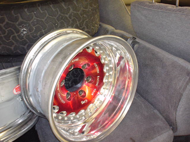

        post a pic of your wheel so we can see what your in for, i've no idea what "dearfield" wheels look like, (i've lead a sheltered life )
        the finished job, i reversed the rim's to get a wider wheel look btw
