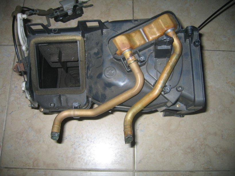

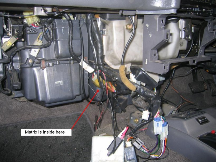

Matrix is burried in the center of the dash. see pic 1
You need to remove the whole dash to get at the center heater box and remove it as the matrix is enclosed in it and pipes go through the bulkhead.

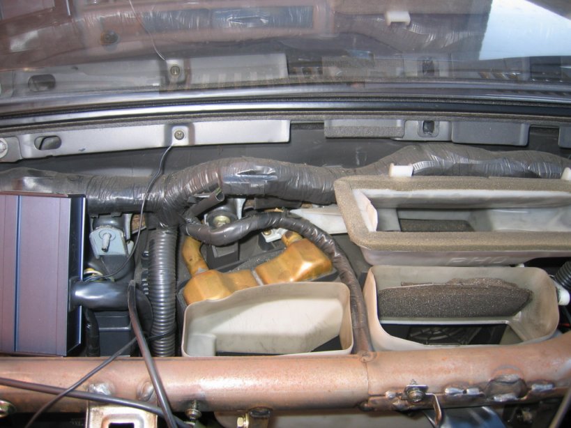

Top of matrix can be seen in the center picture - after top dash is removed.
