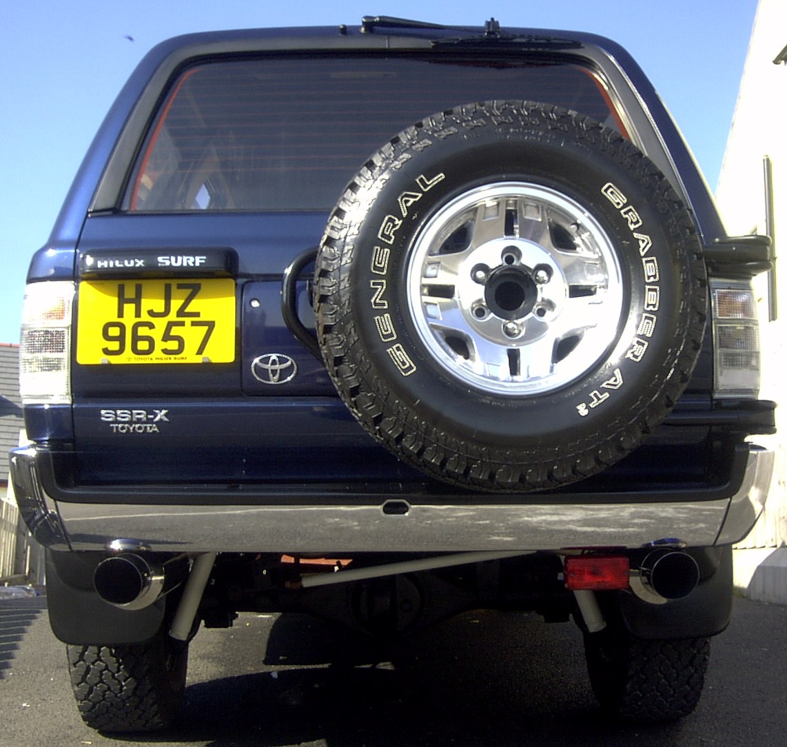

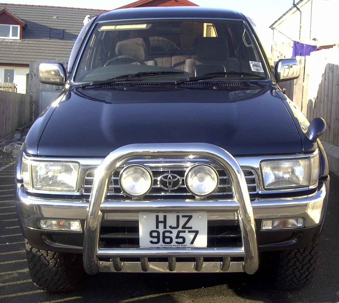

            Gary, your truck is running cooler 'cos it IS cooler with all that painting an polishing!!!
            Sorry, that doesn't help much does it?
            You are a wise and great man Bushwhacker!
            Thank you for noticing!
            My wife cannot notice any difference!
            Just to honour your observations I shall post a pic!
            Keep well!
            Gary

                MY EYES!!!! MY EYES!!!!!

                  Theres a lovely gleaming beast, you Sir are doing the shiny club proud
